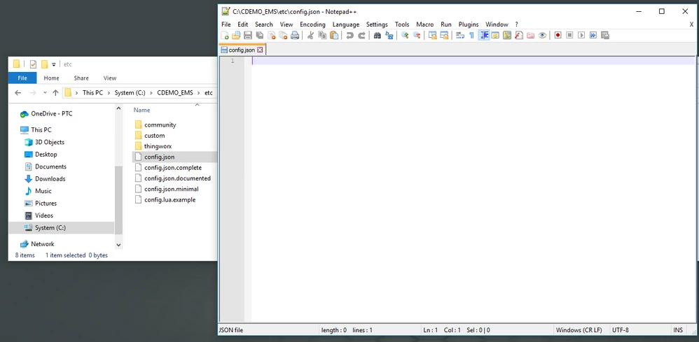

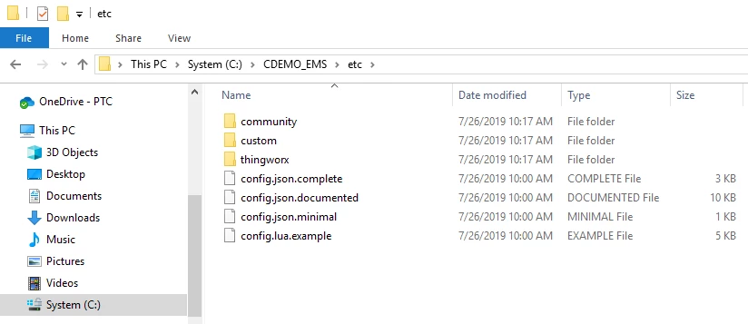

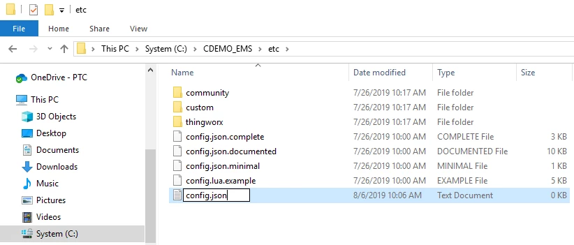

  1. Navigate to the C:\CDEMO_EMS\etc directory.

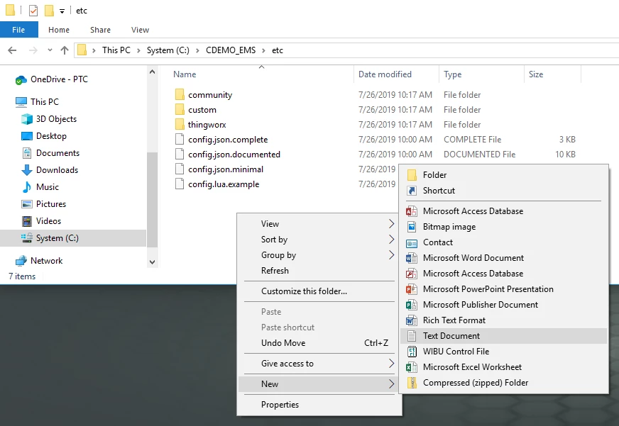

  2. Right-click inside the folder’s white-space and select New -> Text Document.
  3. Change the name of New Text Document.txt to config.json.

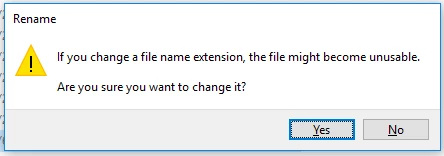

  4. Click Yes in the Rename Popup to confirm the file extension change.
  5. Open config.json in your preferred text editor.
    NOTE
    : You will need a text editor of some type to modify the config.json file. Notepad++ is one such editor. However, the default Windows text editor, Notepad, is sufficient.
  6. Copy and Paste the following code into the empty config.json file:

We pre-defined the parameters for everything that we could, but you will still need to tell the WSEMS the IP address where the ThingWorx instance is located and a valid Application Key you either created earlier or may create now.
TIP: You may have noticed the pre-existing config.json.complete and config.json.minimal files. These are example files that come with the WSEMS and are provided as an aid. The code above which you copied into your own config.json file is simply a customization of these aids. In particular, you may wish to look through the config.json.complete file, as it shows every available option which you might want to configure if you choose to make a custom application with the WSEMS. The config.json.complete file also contains comments for each of these options. However, a functional config.json file may NOT contain comments of any kind, so you would need to remove all comments if you choose to copy/paste some code from that file into a functional config.json of your own making.

    • Click Yes on whether you want to change the filename extension.

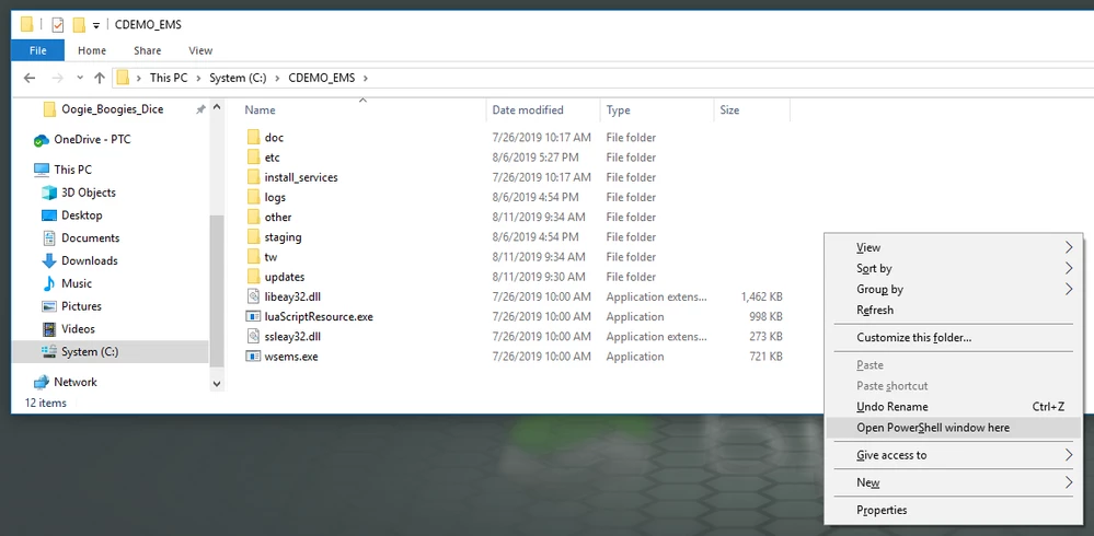

  1. Navigate to the C:\CDEMO_EMS directory.
  2. Hold Shift and right-click in the white space of the folder to open an options menu.
  3. Click Open PowerShell window here.
    • Note that this guide assumes Windows 10, but older versions of Windows have similar command-line interfaces.

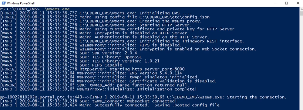

  4. In the PowerShell window, enter the command .\wsems.exe and press the Enter key.
    Note
    : Do not close this window, or the connection to the ThingWorx platform will close. Also, please look through the output in the wsems.exe window. The final line should indicate Successfully connected. Saving .booted config file. If you do not see the Saving .booted comment, then you likely have an error in your config.json file. Close the wsems.exe application with a Ctrl+C and delete any .booted file before making further changes.

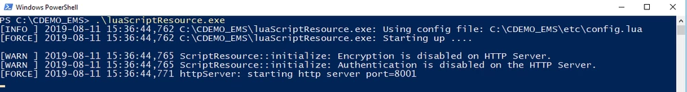

  5. Open another PowerShell window as per the above instructions.
  6. In the second PowerShell window, enter the command .\luaScriptResource.exe and press the Enter key.
    Note: Do not close this second PowerShell window, or the connection to the ThingWorx platform will close.
    NOTE: When the scripts start running, the WSEMS attempts to talk to the ThingWorx platform. However, at this point in the tutorial, ThingWorx does not have detailed information about the Edge device that is attempting to connect to it so you will see an error message. This is the expected behavior which we will resolve in the next step.
The wsems.exe program runs through the config.json file in order to extract the basic connectivity information to reach the ThingWorx platform. The luaScriptResource.exe runs through the config.lua file to extract to which Thing the WSEMS should be connecting. Both .exes must be running in order to achieve connectivity with ThingWorx.
