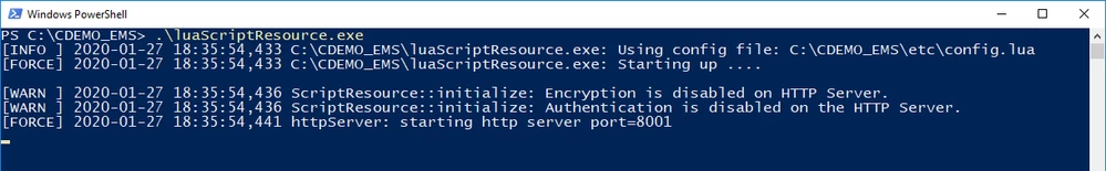

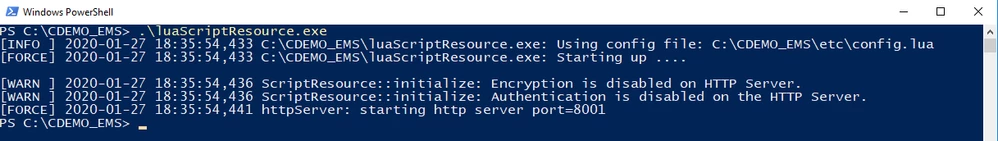

  1. On your Windows PC, select the Windows PowerShell window where the luaScriptResource.exe program is running.
  2. Type Ctrl-C to close the luaScriptResource.exe operation, i.e. hold the Control key and hit the C key.

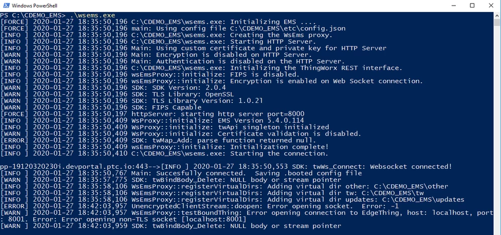

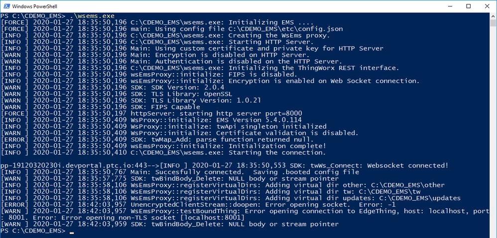

  3. Minimize the luaScriptResource.exe PowerShell window, and activate the wsemse.exe PowerShell window.
  4. Type Ctrl-C to close the wsems.exe operation.

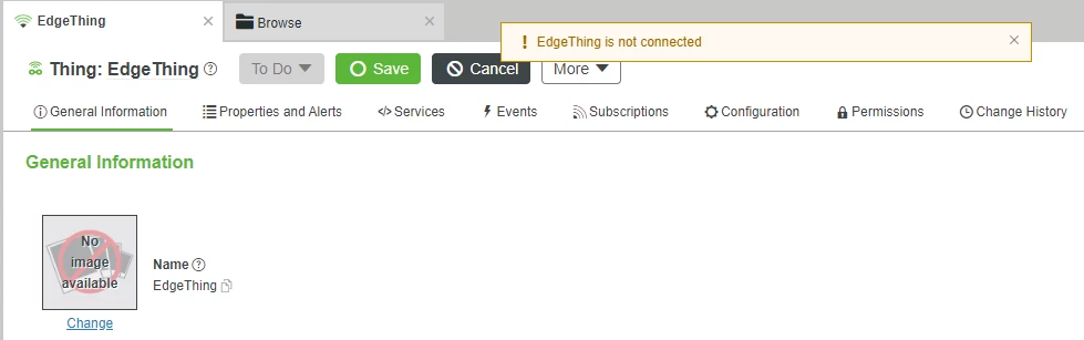

  5. Return to Foundation, and note that EdgeThing is not connected.

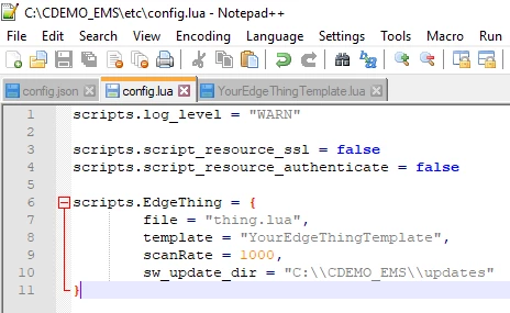

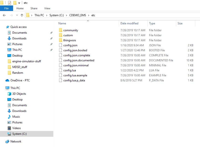

  6. Navigate to the C:\CDEMO_EMSE\etc directory.
  7. Open config.lua in your prefered text-editor.

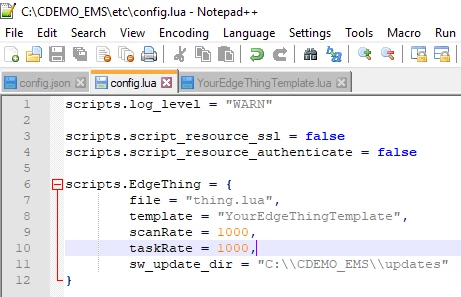

  8. Change scanRate to 1000.
  9. Add the following line below the scanRate line: taskRate = 1000,
  10. The final code of config.lua should be the following
    Note that the EMS may have slightly modified your config.lua file, such as adding a data_security_key line. Leave these EMS-generated modifications alone.
    scripts.log_level = "WARN"
    scripts.script_resource_ssl = false
    scripts.script_resource_authenticate = false
    scripts.EdgeThing = {
     file = "thing.lua",
     template = "YourEdgeThingTemplate",
     scanRate = 1000,
     taskRate = 1000,
     sw_update_dir = "C:\\CDEMO_EMS\\updates"
  11. Save the config.lua file.
