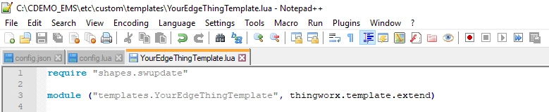

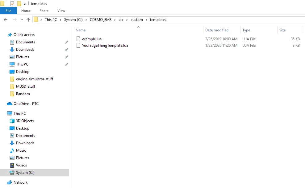

  1. In Windows, navigate to C:\CDEMO_EMS\etc\custom\templates.
  2. In your prefered text-editor, open YourEdgeThingTemplate.lua.

  1. Below the module line of YourEdgeThingTemplate.lua, add the following line to create a low_grease Property:
    properties.low_grease={baseType="NUMBER", pushType="ALWAYS", value=0}
  2. Below that, add the following lines to create the five frequency bands for the first vibration sensor:
    properties.s1_fb1={baseType="NUMBER", pushType="ALWAYS", value=0}
    properties.s1_fb2={baseType="NUMBER", pushType="ALWAYS", value=0}
    properties.s1_fb3={baseType="NUMBER", pushType="ALWAYS", value=0}
    properties.s1_fb4={baseType="NUMBER", pushType="ALWAYS", value=0}
    properties.s1_fb5={baseType="NUMBER", pushType="ALWAYS", value=0}
  3. Below that, add the following lines to create the five frequency bands for the second vibration sensor:
    properties.s2_fb1={baseType="NUMBER", pushType="ALWAYS", value=0}
    properties.s2_fb2={baseType="NUMBER", pushType="ALWAYS", value=0}
    properties.s2_fb3={baseType="NUMBER", pushType="ALWAYS", value=0}
    properties.s2_fb4={baseType="NUMBER", pushType="ALWAYS", value=0}
    properties.s2_fb5={baseType="NUMBER", pushType="ALWAYS", value=0}

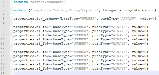

  4. Your code should now look like the picture below.
The code above adds each new Property to the properties structure, and the name of the Property will be what follows after the “.”, i.e. low_grease, s1_fb1, s1_fb2, etc.
In addition, the baseType defines the type of each Property, in this case, all Numbers.
The pushType of ALWAYS means that there are no restrictions on sending new Property values up to Foundation, and the value of 0 indicates the default value to which each Property will initially be set.

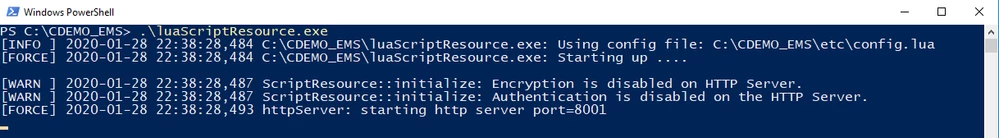

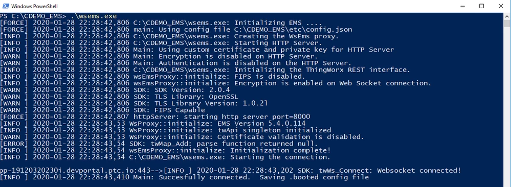

  1. Restart the wsemse.exe program by returning to its PowerShell window and executing the following command: .\wsems.exe
  2. Restart the luaScriptResource.exe program by returning to its separate PowerShell window and executing the following command: .\luaScriptResource.exe

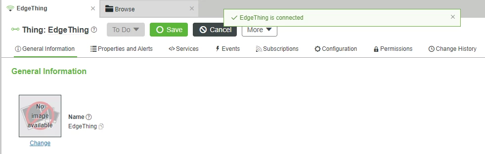

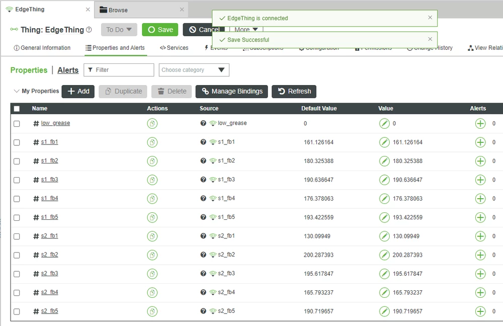

  3. Return to ThingWorx Foundation's EdgeThing.
    Note that EdgeThing is connected.

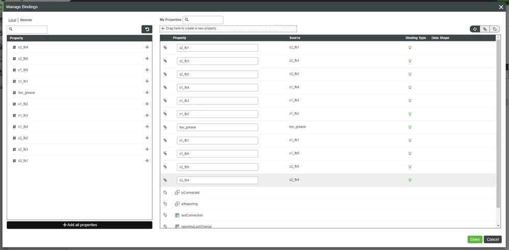

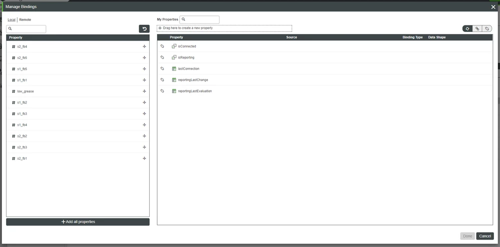

  4. On the Properties and Alerts tab, click Manage Bindings.
  5. At the bottom-left of the Manage Bindings pop-up, click + Add all properties.
  6. At the bottom-right of the pop-up, click Done.

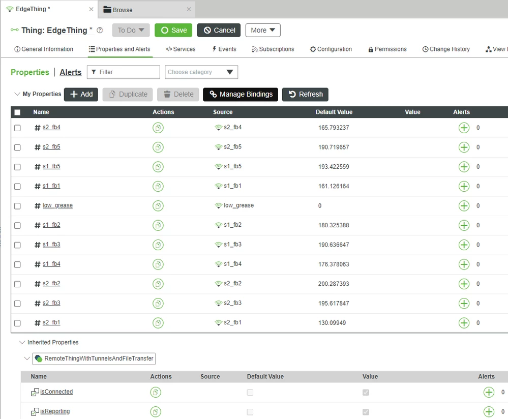

  7. At the top, click Save.

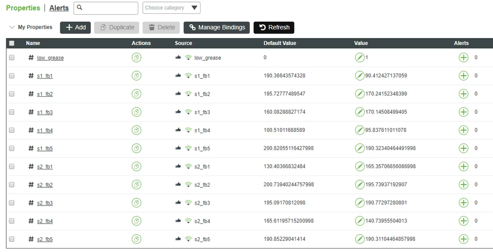

  8. Near the top, click Refresh repeatedly.
    Note that the Property values consistently change.
