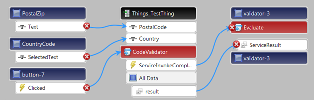

  • Set up a simple mashup to collect the parameters and pass them into our service

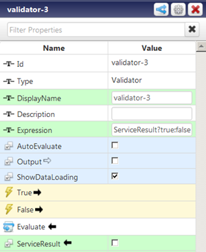

  • Add a validator widget

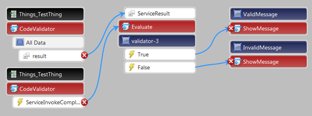

  • Configure the validator widget to parse the output of the service. ServiceInvokeComplete on the service should trigger the evaluation and pass the result of the service into a new parameter on the widget called ServiceResult (Boolean). The expression for the evaluator would then be: ServiceResult? true:false
  • Based on the output of the validator, provide a message confirming the postal code is valid or invalid
  • Add a button to activate the service and the validator evaluation
