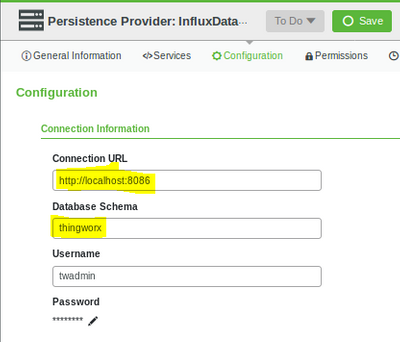

2. Create Influx Persistence Provider
and configure

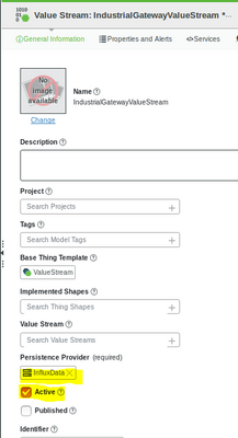

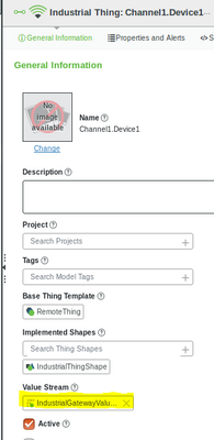

3. In the Industrial Thing where the Remote Properties are bounded define Value Stream
and make sure to have Persistence Provider set to Influx and is set to Active

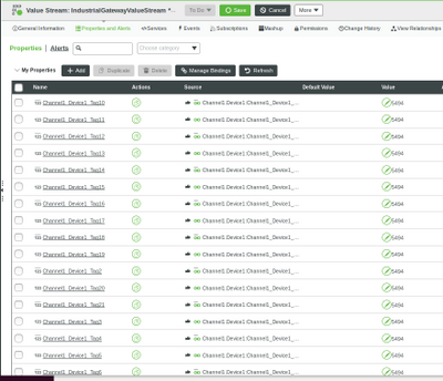

4. In the Value Stream Properties and Alerts define the mappings using Manage Bindings to specify what properties are to be stored in this value stream
