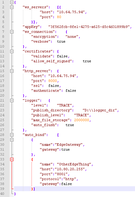

Once we have obtained the EMS download from the support site (see the section above for links) we can begin creating our config.json file.
The image below is a working config.json file for using the EMS as a Gateway. The settings in here are particular to my personal IP addresses and Application Key, but the concept remains the same, and I will go into further detail on the necessary sections, below the image.
  • ws_servers
    • The host and port parameters are always set to the IP address and port that the ThingWorx platform is being hosted on
    • When the EMS and ThingWorx platform are on the same server, "localhost" can be used instead of an IP address
  • appKey
    • The appKey section is the value of an Application Key in the ThingWorx platform that should be used for the authentication of the EMS to the platform
    • An Application Key will need to be created and assigned a user with proper priveledges prior to authenticating
  • certificates
    • The certificates section should be validating and pointing to proper certificates, but in the example above I am not validating any certificates for the sake of simplicity
    • More can be read about the certificates sections here
  • logger
    • The logging section is out of scope of this article, but further reading on ​logger​ configurations can be found here
    • The section in the example above will work for basic logging needs
  • http_server
    • The http_server section configuration parameters will tell the EMS what host and port to spin up a server on and if there is authentication necessary by any LSRs trying to connect
    • The LSR has settings that will explicitly call out whatever value is set to the host and port in this section, so make sure to set these to an open port that is not in use or blocked behind a firewall
    • Further reading on the http_server section can be found here
  • auto_bind
    • You can see above that there are two objects defined in the auto_bind section. One of these is binding the EMS to an EMSGateway Thing in the platform called "EdgeGateway" and the other is defined in the config.lua file for the LSR
    • The gateway parameter is set to true only in the object, "EdgeGateway", that is being used for the EMS to bind to
    • The host and port defined for the "OtherEdgeThing" should point to the port and IP address that the LSR is running on in the other device
      • By default, the LSR runs on port 8001, but you can always double check the listening port by finding the Process Identification (PID) number of the luaScriptResource.exe and then matching the PID to the corresponding line item in the output of netstat -ao command in a console window
    • The protocol can be set to "http" in an example application, but make sure to use "https" when security is of concern
All further reading on the sections of the config.json file can be found in the config.json.complete file included with the EMS download and on the Edge Help Center under the "Creating a Configuration File" section and the "Viewing All Options" section.

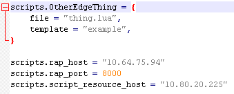

Setting up the LSR
In this example, the LSR is going to run on a separate server and point to the EMS server. Below is a screenshot of two very important additions (rap_host and rap_port) to the default config.lua file:
  • rap_host
    • The rap_host field should be set to the IP address where the EMS is hosted
  • rap_port
    • The rap_port field should be set to the port parameter defined in the config.json http_server section
  • script_resource_host
    • The ​script_resource_host​ field must be set to ensure that the EMS will know what IP address to communicate with the LSR at
  • scripts.OtherEdgeThing
    • This line is necessary to identify what the name of the LSR is that will register with the EMS to bind to the platform
    • "OtherEdgeThing" can be changed to anything, but make sure that the auto_bind section in the config.json aligns with what you've defined in the config.lua file at this line
