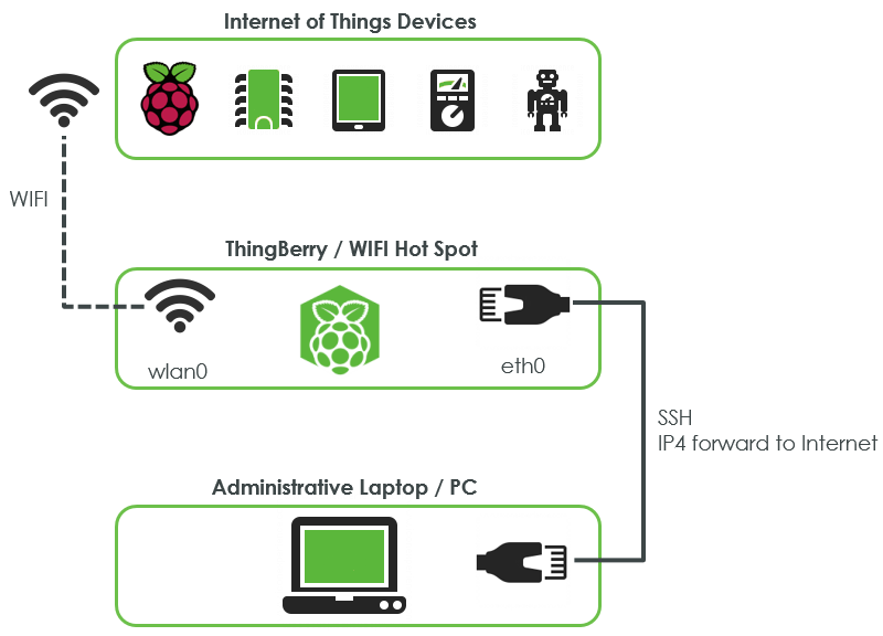

ThingBerry is ThingWorx installed on a RaspBerry Pi, which can be used for portable demonstrations without the need of utilizing e.g. customer networks. Instead the ThingBerry provides its own custom WIFI hotspot and allows Things to connect and send / receive demo data on a small scale.
In this particual blog post we'll discuss on how to setup the ThingBerry as a WIFI hotspot to directly connect with mobile devices or other Raspberry Pis.

As the ThingBerry is currently connected via ethernet we can utilize the Raspberry Pi's WIFI connection to create a private network where all the wireless devices can connect to, e.g. another Raspberry Pi or a ESP8266
First we need to install dnsmasq and hostapd. Those will help setting up the access point and create a private DNS server to dynamically assign IP-addresses to connecting devices.

Optional: Internet Access
The ThingBerry is independent of any internet traffic.
However if your connected devices or the ThingBerry itself need to contact the internet, the WIFI connection needs to route those packages to and from the (plugged-in) ethernet device.
This can done through iptables
sudo iptables -t nat -A POSTROUTING -o eth0 -j MASQUERADE
sudo iptables -A FORWARD -i eth0 -o wlan0 -m state --state RELATED,ESTABLISHED -j ACCEPT
sudo iptables -A FORWARD -i wlan0 -o eth0 -j ACCEPT
All traffic will be internet related traffic will be forwarded between eth0 and wlan0 and vice versa.
