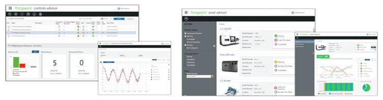

With the release of ThingWorx 8.5, we’ve incorporated a lot of new functionality into our manufacturing and service apps. To cover a few, I’ve included the list below.
  1. We created a manufacturing common layer extension to bundle all the PTC-offered IoT apps (Operator Advisor, Asset Advisor, Production KPIs and Controls Advisor) into one extension to enable you to use them even more quickly.
  2. We added a UI to Operator Advisor to strengthen your development of work instructions.
  3. We introduced new shift and crew data models and user interfaces to standardize how to track workers’ shifts and crew availability.
  4. We also introduced Flexible KPIs to help you more rapidly develop apps to calculate common metrics.
  5. We enhanced the Operator Advisor MPMLink connector to allow users to access navigation criteria for filtering parameters based on required criteria with support for standard processes.
  6. We incorporated multiple context supports for assets—like different business units, separating maintenance views from production views or segmenting sites by location—to allow segmentation based on role and responsibility, showing the power of ThingWorx networks and permissions.
