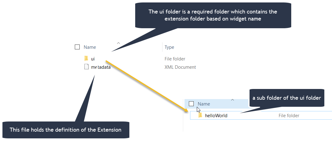

The attached zip when unzipped will contain a folder called ui and metadata xml file. Within the ui folder there needs to be a folder that has the same name as the widget name. In this case its helloworld.

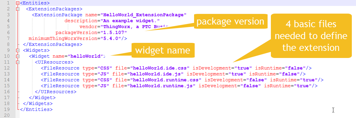

Metadata file - The 3 callouts are the most import.
  • Package version: is the current version and each time a change is made the value needs to be updated.
  • name: a unique name used through out the widget definition
  • UIResources: The source locations for the widget definition.
The UIResources files are used to define the widget in the ide (Composer) and runtime (Mashup). These 2 environments ide and runtime have matching pairs of css (cascading style sheets)  and a js (javascript) files.

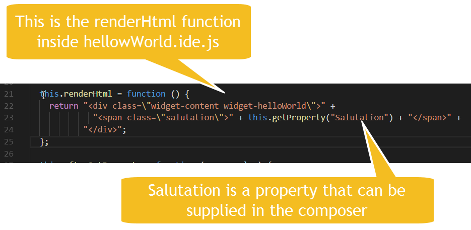

The js files are where most of the work is done. There a number of functions used inside the javascript file but just to get things going we will focus on the renderHtml function. This is the function that will generate the HTML to be inserted in the widget location.
renderHtml(helloWorld.ide.js)

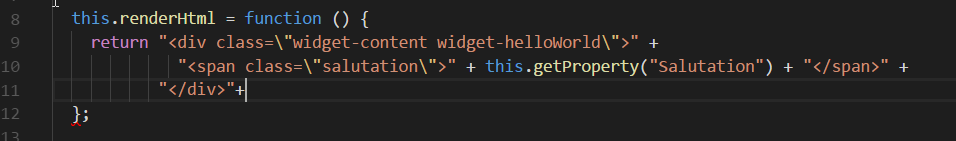

In this very simple case the renderHtml in the runtime is the same as in the ide
renderHtml (helloWorld.runtime.js)
Hopefully you can see that the HTML is pretty easy just some div and span tags with some code to get the Property called Salutation.

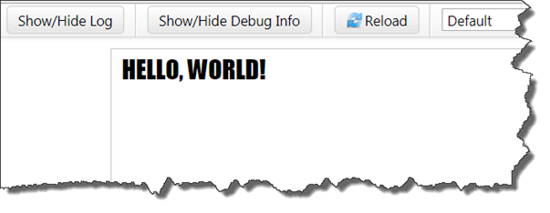

The UI and metadata.xml file needs to be zipped up (as per attachment).  Below is a animated gif that shows how to import and use the widget
Very Quick Steps to import and use in mashup.
