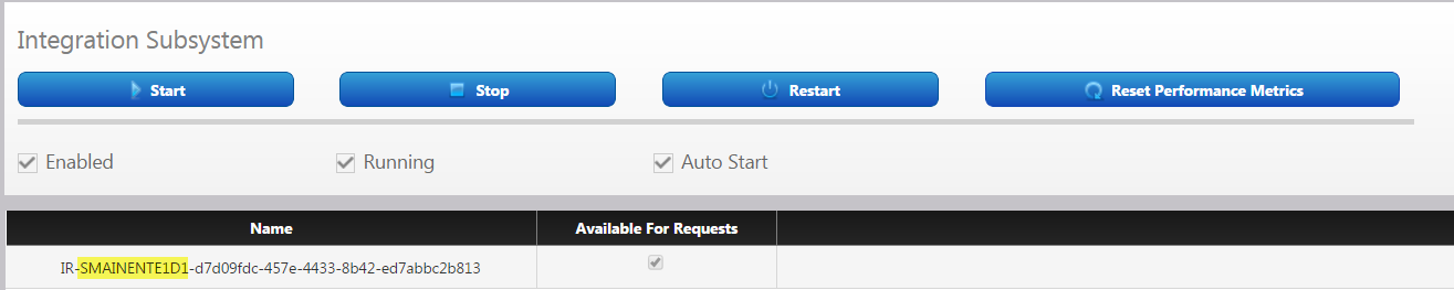

Monitoring the Integration Runtime microservice
     In the ThingWorx composer : Monitoring > Subsystems > Integration Subsystem
     SMAINENTE1D1 is the hostname of my Integration Runtime server.

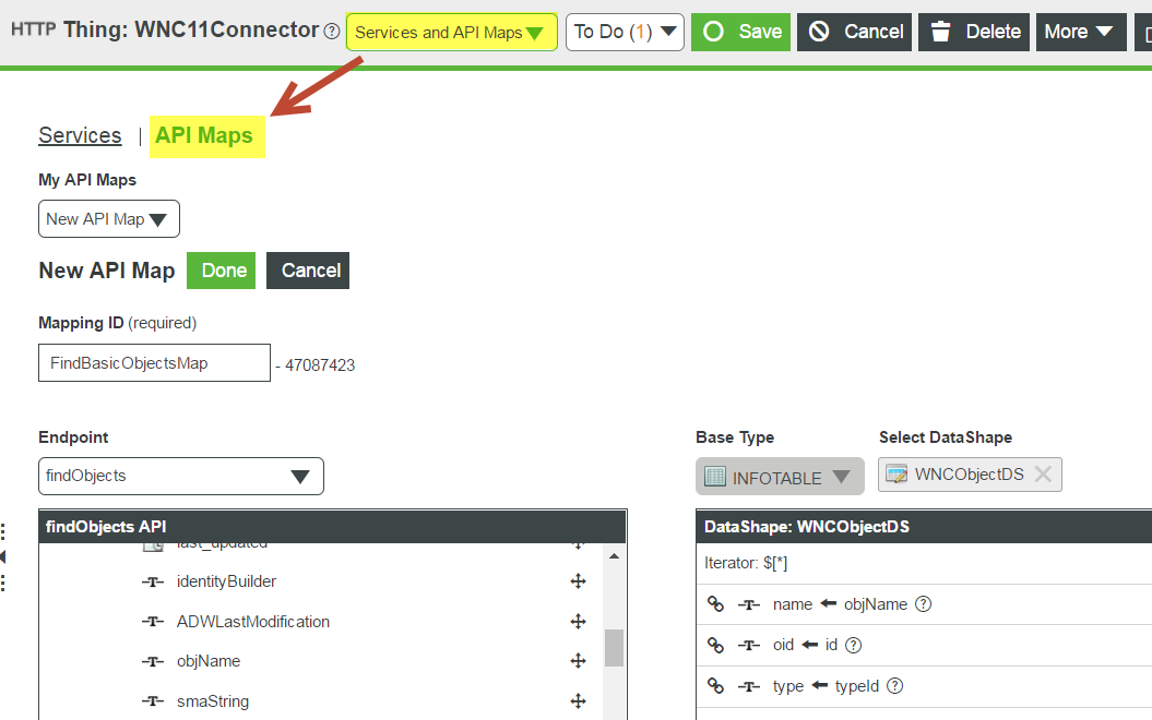

4. Create an API maps under WNC11Connector > Services and API Maps > API Maps (New Composer only)
    • My API Map : New API Map
    • Mapping ID : FindBasicObjectsMap
    • EndPoint : findObjects (choose the first one)
    • Select DataShape : WNCObjectDS (created at step 1) and map the following attributes :
      • name <- objName ($.items.attributes)
      • type <- typeId ($.items)
      • oid <- id ($.items)
After pressing [done] verify that the API ID is '/objects GET' (and not /structure/objects - otherwise recreate the mapping and choose the other findObjects endpoint).

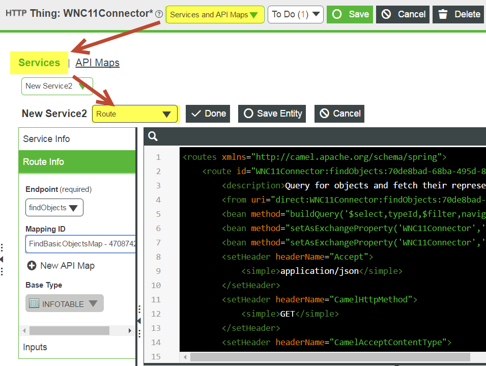

5. Create a "Route" service under WNC11Connector > Services and API Maps > Services (New Composer only)
    • Name : FindBasicObjects
    • Type (Next to [Done] button) : Route
    • Route Info | Endpoint : findObjects (same as step 4)
    • Route Info | Mapping ID : FindBasicObjectsMap-xxxx created at step 4

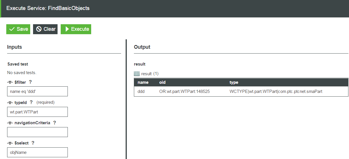

Testing our custom WindchillSwaggerConnector
Test the WNC11Connector::FindBasicObjects service
Note that the id (oid) and typeId (type) are returned by default by the /objects REST API - objName has to be explicitly requested.
