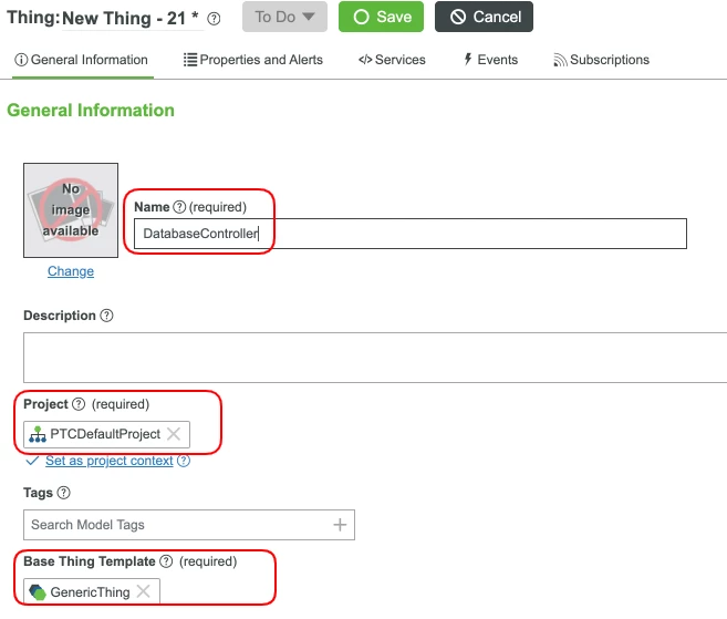

To create a connection and begin working with an external database, you will need to create a database Thing and set up the connection string and credentials. (To see the final version of this entity, you can look at SQLServerDatabaseController.)

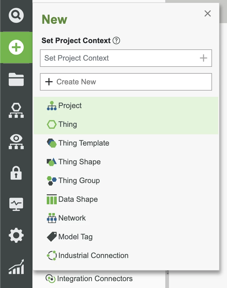

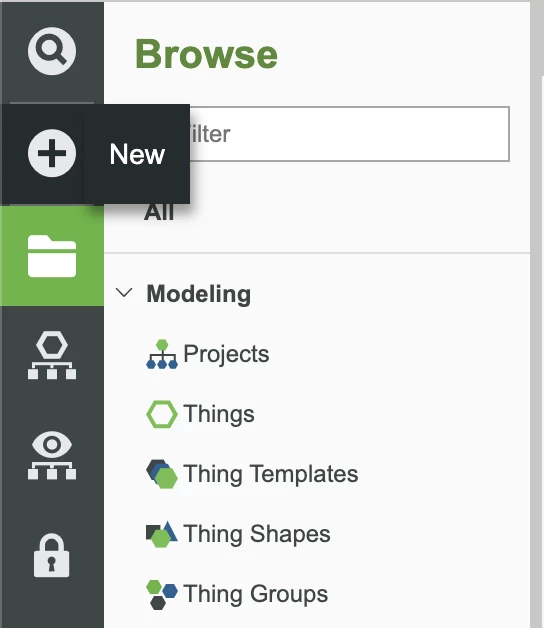

  1. In ThingWorx Composer, click the + New at the top of the screen.
  2. Select Thing in the dropdown.
  3. Name the Thing DatabaseController and select Database as the base type.
  4. Set the Project field (ie, PTCDefaultProject).
  5. Click Save and go to the Configurations tab.

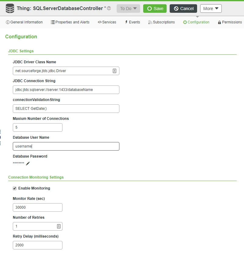

In this tab, you will enter the class name of your driver, the connection string for that database connection, and the credentials to access the database.
Keep in mind, the JDBC Driver Class Name, JDBC Connection String, and the connectionValidationString values are all database type specific. For example, to connect to a SQL Server database, the below configuration can be used.
 Title                                              Description                    Example
JDBC Driver Class NameThe specific class name of the driver being used for the connection.net.sourceforge.jtds.jdbc.Driver (SQL Server) or oracle.jdbc.driver.OracleDriver (Oracle)
JDBC Connection StringThe connection string to locate the database by host/port/database name.jdbc:jtds:sqlserver://server:port/databaseName (SQL Server) or jdbc:oracle:thin:@hostname:port:databaseName (Oracle)
connectionValidationStringA simple query that should always work in a database.SELECT GetDate() (SQL Server) or SELECT SYSDATE FROM DUAL (Oracle)

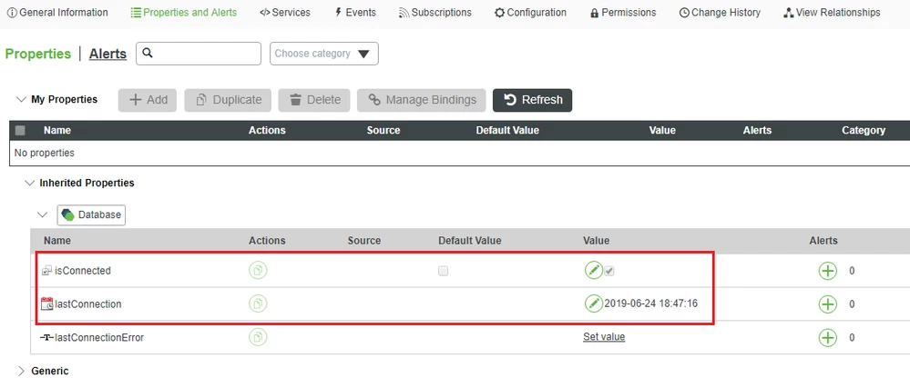

  2. Go the Properties and Alerts tab.
  3. You'll see properties showing the connection validation similar to the image below. If you don't have a connection as yet, work on your configuration information and validate the credentials being used. If you're still having troubles after that, see the examples section below or use the next section for help to try a query of the database.

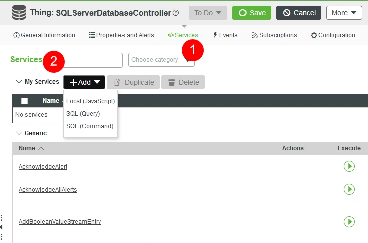

  1. In the DatabaseController entity, go to the Services tab.
  2. Create a new service of type SQL (Query) called RunDatabaseQuery.

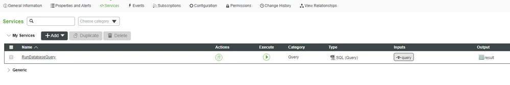

6. Click Save and Continue. Your service signature should look like the below example.
You now have a service that can run queries to the database. This is also a simple method to test/troubleshoot the database connection or a quick query.

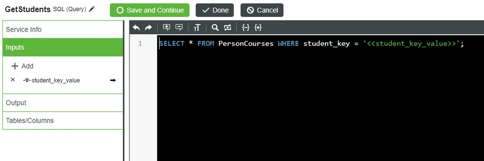

Now, let's utilize the second method to create a query directly to the database. You can use open and close brackets to create parameters for your query. You can also use <> as a method to mark a value that will need to be replaced. As you build your query, use [[Parameter Name]] for parameters/variables substitution and <> for string substitution.
  1. In the Services tab of the DatabaseController entity, create a new service of type JavaScript.
  2. Name the service SQLQuery_GetPersonByEmail.
  3. Ensure the Output is InfoTable.
  4. Add the following code to your new service:
SELECT * FROM Persons WHERE person_email = [[email]];
5. Add the following parameter:
 Name          Base Type    Required
emailStringTrue
An example of using the string replacement is as follows:
DELETE FROM <> WHERE (FieldName = '[[MatchName]]');
DELETE FROM << TableName >> WHERE ( FieldName = [[MatchNumber]]);
