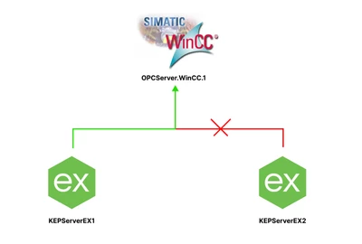

2 Kepserver connected to 1 OPCServer.WinCC.1
I want to migrate a server. I have 3 servers in the same domain
1 server for WinCC SCADA I'll call A
Server B is the standby Server now and is connected to WinCC Server A with OPC DA.
and now I want to migrate Kepserver from B to C.
I tried connecting Server C with Server A WinCC (OPCServer.WinCC.1) while Server B was still connected to Server A.
the entire setup is the same as server B.

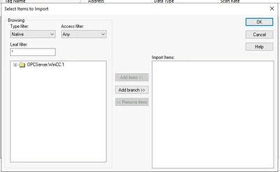

and, from server C, I can scan all tags from server A WinCC
but it takes 1-2 minutes for this pop-up appear.
when I try to open quick client, the quality is always bad, and sometimes "out of service"
and there is a message said "Failed to establish callback......"
Is there a possibility that the WinCC Server from server A can only connect to 1 Kepserver with OPC DA?

It is possible the WinCC application only supports a single connection, and you may need to contact their support for verification.  As a test can you disconnect the connection to "KEPServerEX1 and attempt the connection to KEPServerEX2? If the single connection to KEPServerEX2 still fails, then it is most likely a DCOM issue.
