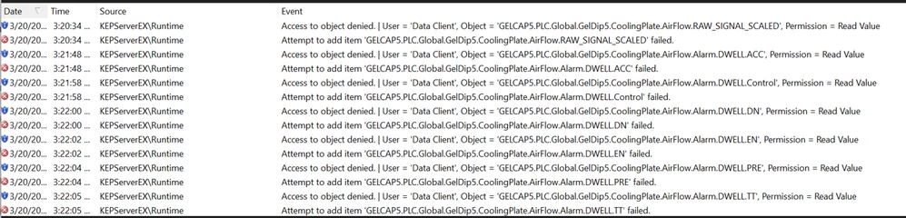

acess to object denied in kepware issue
could you please let me know how to relsolve issue.

  • User can not see any tag on Quick Client
  • Getting error
Access to object denied. | User = 'Data Client', Object = Channel.Device.Tag, Permission = Read Value
Additional Context

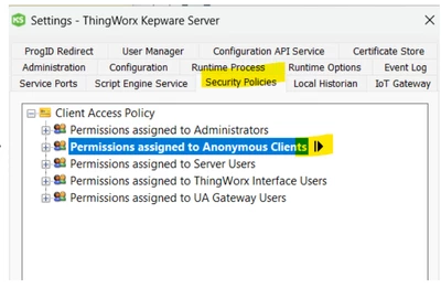

Cause
  • Permissions are denied
Resolution
  • Go to  the Administration Utility > Settings > User Manager > Anonymous Clients >  I/O Tag Access
    • Set Read/Write Value = Allow
OR
  • Check the security policy under Administration Utility > Settings >Security Policies>Permission Assigned to Anonymous Clients and clear the saved one
  • Note- Someone might have configured this for safety, so it is suggested to check with your team
