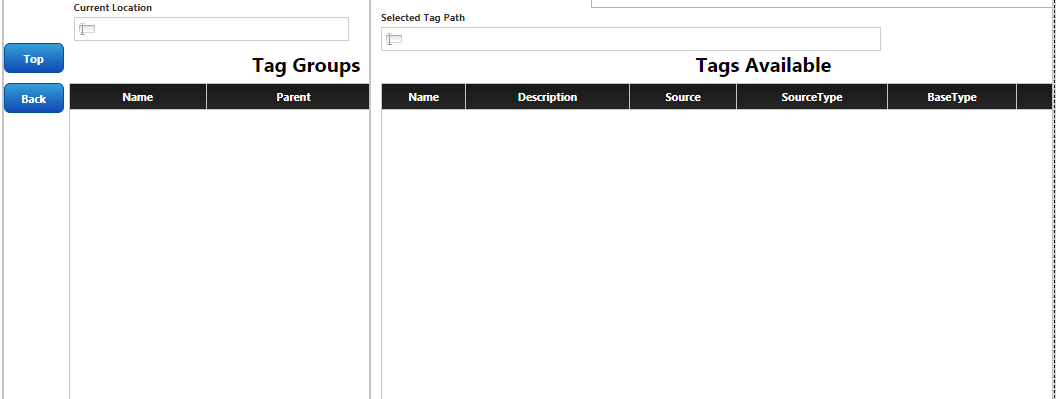

I've created a mashup to browse the groups and tags available on a KEPServerEX instance using the given 'BrowseItems' and 'BrowseGroups' services available with the 'RemoteKEPServerEXThing' Thing Template.  I've bound 'All Data' from their returns to 2 grid widgets, 1 for BrowseGroups and 1 for BrowseItems.  I created a helper Thing to assist with navigation on the mashup and whatever other services I need to write.  I know that this functionality is working.
I want to add functionality that allows you to multiselect tags from the BrowseItems grid and use the AddItems service to attach them to my KEPServer Thing in Thingworx.
Figure: Left grid displays the results of 'BrowseGroups', Right grid displays the results of 'BrowseItems'.
For some reason, I'm not able to directly use Connections in mashup builder to connect data from 'SelectedRow(s)' from BrowseItems to the 'Parameters' for AddItems.

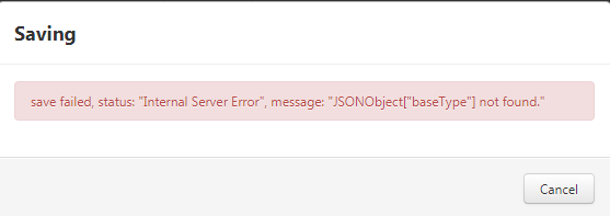

​where KEPServerEXthing is the Thing that the AddItems service is executed on.  If I go into "Manage Bindings" in Properties on the KEP Thing and add the tags as Properties, it won't let me save the KEP Thing and gives this error:
Then if I go into Manage Bindings again (without cancelling the Thing edit) multiple "undefined" rows show up.

Best answer by Ascherer17
Thingworx 7.1 and KEPServerEX 6.2.
It turns out it had something to do with using $ symbols in the Name or Source field.  Although Thingworx and KEPServer both allow using $ in Property names or Channel, Device, Tag names, the $ seems to be a delimiter in KEPServer's interfacing with Thingworx.
Once we changed all the $'s in our tags, they rebound correctly upon a restart.
It was odd that error checking didn't seem to be performed in AddItems to let you know that restricted characters were given as input.
