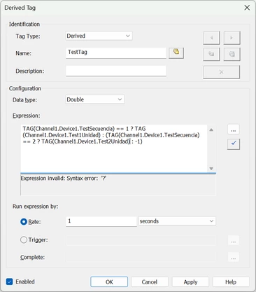

Hello community,
I would like to know if it's possible to create a nested condition formula using a Derived Tag in Advanced Tags in KEPServerEX. Something "Condition ? Value_if_True : Value_if_False"
The idea is to retrieve certain tag based on a tag value, for example:
plc1secuence == 1 ? plc2tag1 : plc1secuence == 2 ? plc3tag1 : -1
Tried using IIF statement as well but it doesn't like it either...
Looking forward to hear from you.

Hello Shashi,
Thank you for your reply. I had tried your suggestion before but it does not like the "ternary operator expression".
Downloaded the latest version just in case this was added in newer versions but nothing (same syntax error as usual).
Tried the following dummy examples:
TAG(Channel1.Device1.TestSecuencia) == 1 ? TAG(Channel1.Device1.Test1Unidad) : TAG(Channel1.Device1.Test2Unidad)
(TAG(Channel1.Device1.TestSecuencia) == 1) ? TAG(Channel1.Device1.Test1Unidad) : TAG(Channel1.Device1.Test2Unidad)
The nested one (the one you described in your post - using grouping parentheses):
TAG(Channel1.Device1.TestSecuencia) == 1 ? TAG(Channel1.Device1.Test1Unidad) : (TAG(Channel1.Device1.TestSecuencia) == 2 ? TAG(Channel1.Device1.Test2Unidad) : -1)
All previous examples throw: "Expression invalid: Syntax error: '?'"
Currently using KEPServerEX 6.17, V6.17.269.0 (customer running older: V6.9.572.0)
