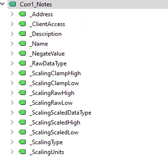

Somehow, In my OPC UA server, all tags got 15 subtags.
These subtags are not visible in Kep Quick Client or in the Kepserver Configuration Window but visible in UaExpert or other OPC UA Clients.
I want to stop it. Please guide me how to deactivate this!

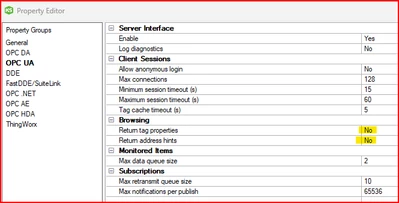

In Project Properties > OPC UA, you can disable hints and properties.
-Andy
