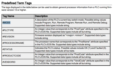

on the Logix platform, why would @MODE work as a tag  but @IsPresent will not pass Syntax check?  Both are valid.
(v6.12)

It appears that both are Predefined Term Tags. However, currently, only #MODE is supported by our driver (page=66).
To include the other tag, it requires an enhancement request. Please review the article linked below for guidance on submitting this request to our Product Management team:
