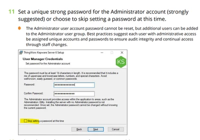

Authentication for Kepware Demo - OPC UA - Python
I’m having trouble testing the Kepware server with Python and OPC UA because there’s no way to set an admin password. This makes it tricky to test authentication properly and get my scripts to work the way they’re supposed to.

rajskumarAnswer
Dec 16, 2024 12:36 PM UTC
It seems you are on the right track. When prompted to set up an admin/password, you can either create a new one or skip this step by clicking on "Skip Setting" (not recommended)(refer below screenshot).

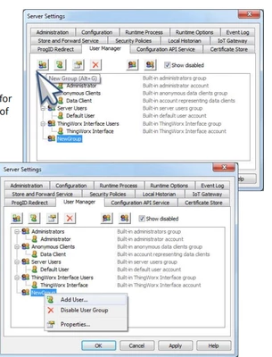

Hello, You can Create a server user group for the specific purpose of using the OPC UA interface and adjust the permissions for that group .
1. Open the User Manager in Settings.
2. Click New Group.
3. Assign permissions to the new group
4. Right-click on the new group.
5. Click Add User.
6. Set a strong password.
Note- The password must be at least 14 characters in length and include a mix of uppercase and lowercase letters, numbers, and special characters.

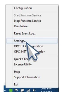

Here is how you can find the above settings:-
1. Open the Administrative Settings by right-clicking the product icon in the system tray and choosing Settings.
2. Select the User Manager tab.
