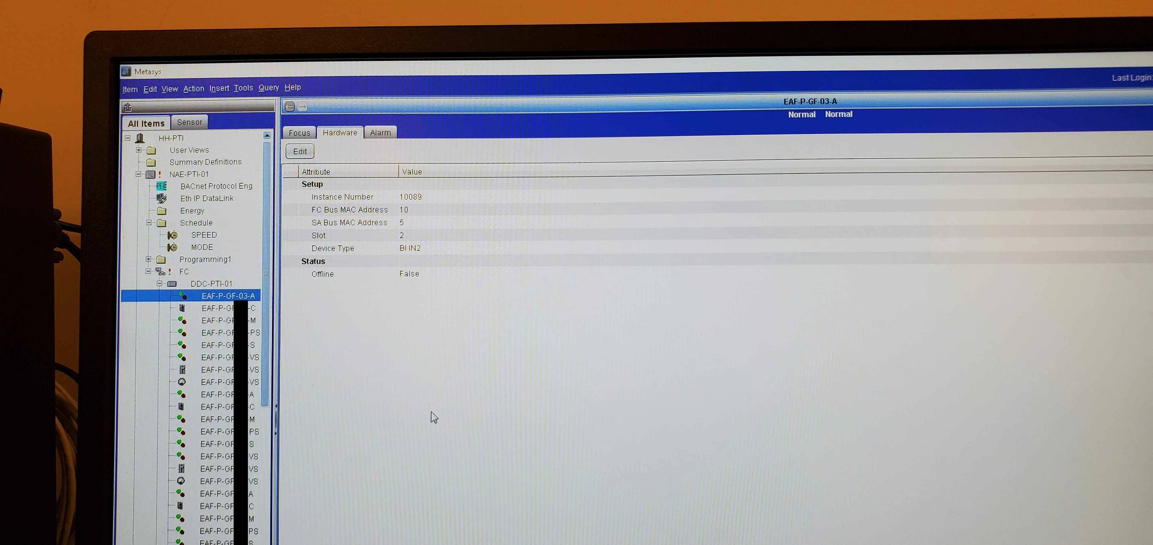

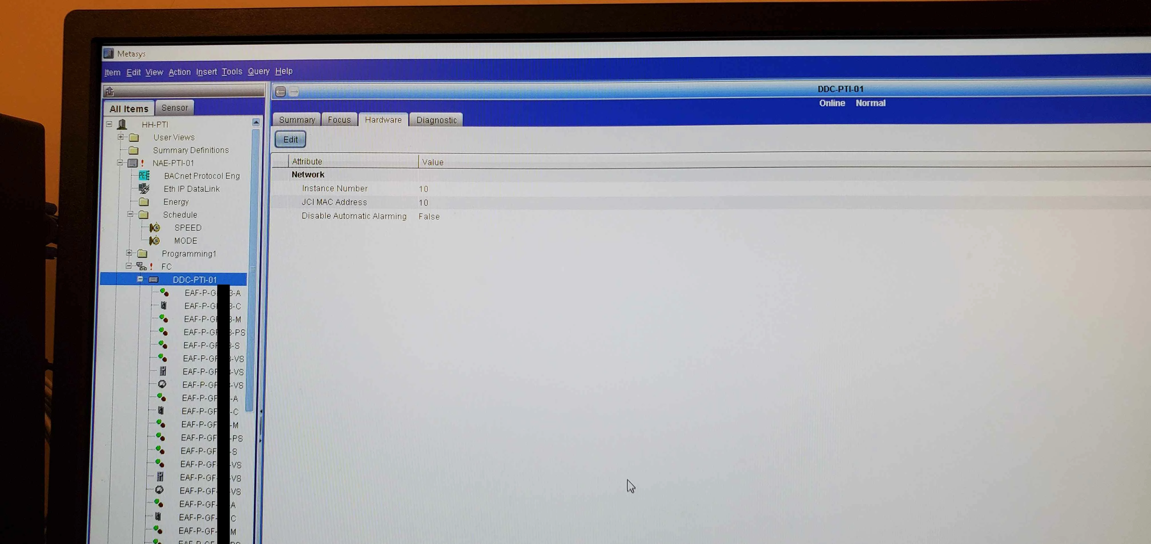

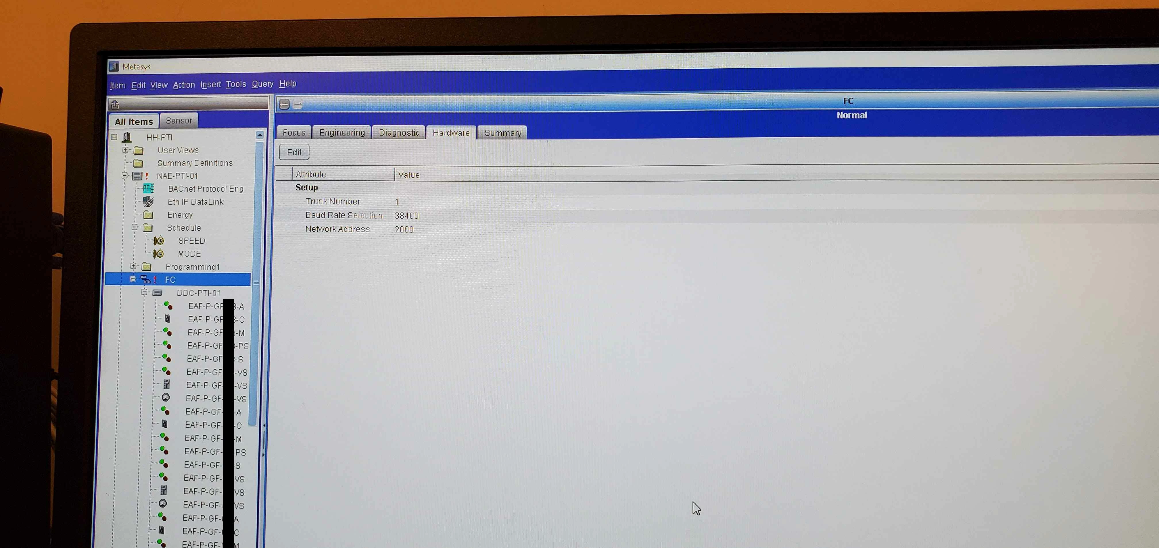

Hi Chris, thanks for your reply! Let me describe more details on our current job background. Two existing sites have been installed with Johnson Controls NAE and Schneider SmartX controllers respectively for Building Services equipment monitoring and control through BACnet protocol. One workstation in each site is installed with their own brand SCADA software through BACnet I/P. In this case, without interrupting the existing operation, our missions are to:
  1. Provide a new PC/server in both sites which respectively connects to the following controllers (one at time) by KEPServerEX BACnet I/P driver in order to get the tag data from them:
    • Johnson Controls NAE
    • Schneider SmartX
  2. Convert the obtained tag data into JSON format and export to the PC directory (e.g. FTP server) as a .json file for the web-based application to read.
As mentioned in problems #3 and #4 in previous post, I am not familiar with BACnet I/P configuration details. I wonder what the differences between local device instance (channel protocol setting) and ID (device general setting) are. Take Johnson Controls as an example. Three device levels, each has its own network address / instance number, are found: FC under NAE (controller), DDC (Remote I/O) and Field equipment. The screenshots are attached for your information. Please advise which is which. Thanks!
