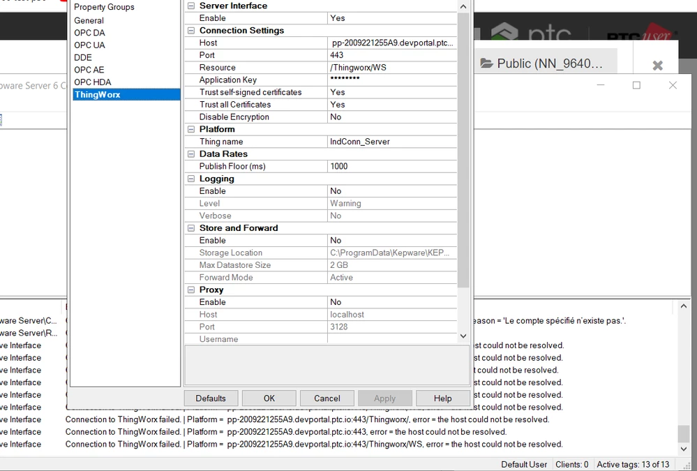

I have followed this guide : https://developer.thingworx.com/en/resources/guides/connect-kepware-server-thingworx-guide/connect-foundation
I can't connect Kepware with Foundation.
Kepware logs tell that the host could not be resolved.
I have the trial version of Fundation.
"Error ThingWorx Native Interface Connection to ThingWorx failed. | Platform = pp-2009221255A9.devportal.ptc.io:443/Thingworx/WS, error = the host could not be resolved."
I have no clue why. I did create an app-key, with no ip restriction, i'm HTTPS with Fundation...
cf screenshots below
PS: i have the same problem connecting Fundation to Azure.
Best answer by NN_9640323
Thank you for your fast answer.
After trying everything else, i tried to switch from my company laptop to my personal computer and guess what... it works !
My guess is that the firewall configured by my company was blocking the connection !
Thnak you very much !

HI @NN_9640323.
Since you're connecting to a trial instance, there may be some restrictions that would prevent you from being able to connect--possibly even on your side at the server/network where your Kepware is located.
However, I noticed you have the setting "Disable Encryption" as "No".  Change this to "Yes" and see if anything changes.  If not, please provide the version of ThingWorx and Kepware you are running.

September 24, 2020
