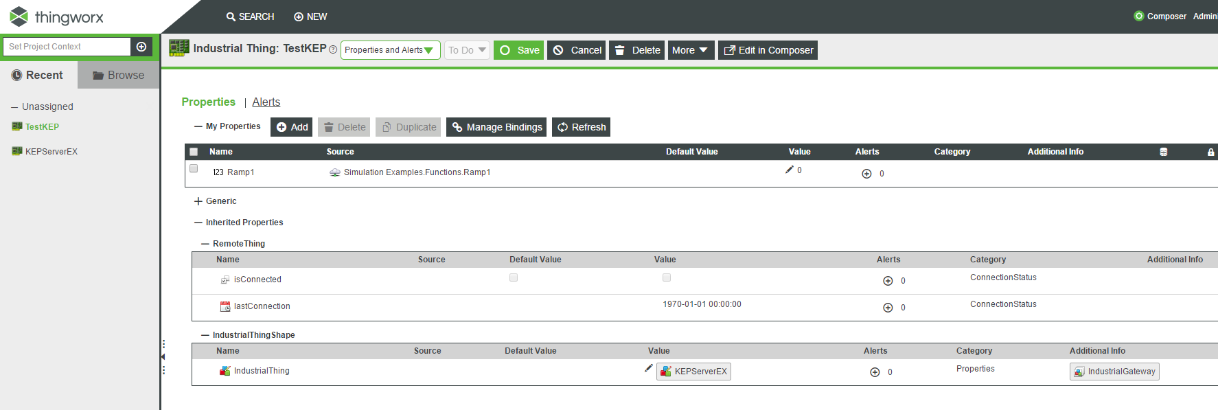

I have connected thingworx to kepware but I cannot see any values in thingworx. I have followed the guide "industrial Connections" in the Thingworx Help Center; I created a thing with the industrial gateway template, I connected kepware to the thing and, in new composer, I searched for the tags and bound them to a new entity. Everything good so far, but when I open the new industrial thing and click on Refresh to see the values, I cannot see any value. In the remote thing properties I can see that I has never been connected despite the Industrial Connection thing is connected.
Any clue about what is going on?
KEPServerEx is the industrial connection and TestKEP is the industrial thing.

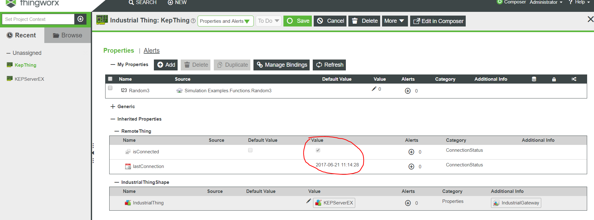

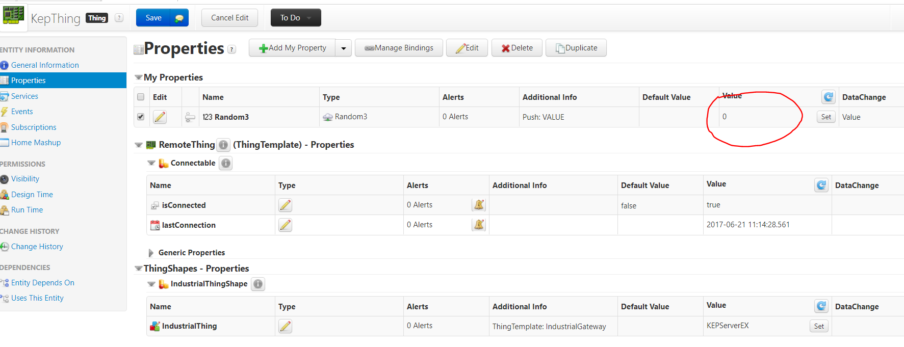

Thank you very much for your fast response. Disabling the legacy mode I get the industrial thing connected but I cannot get values when refreshing. If I go to industrial thing (KepThing), as mentioned Pai, the values are not updating on it.
  • Industrial gateway: KepserverEX
  • industrial thing: KepThing

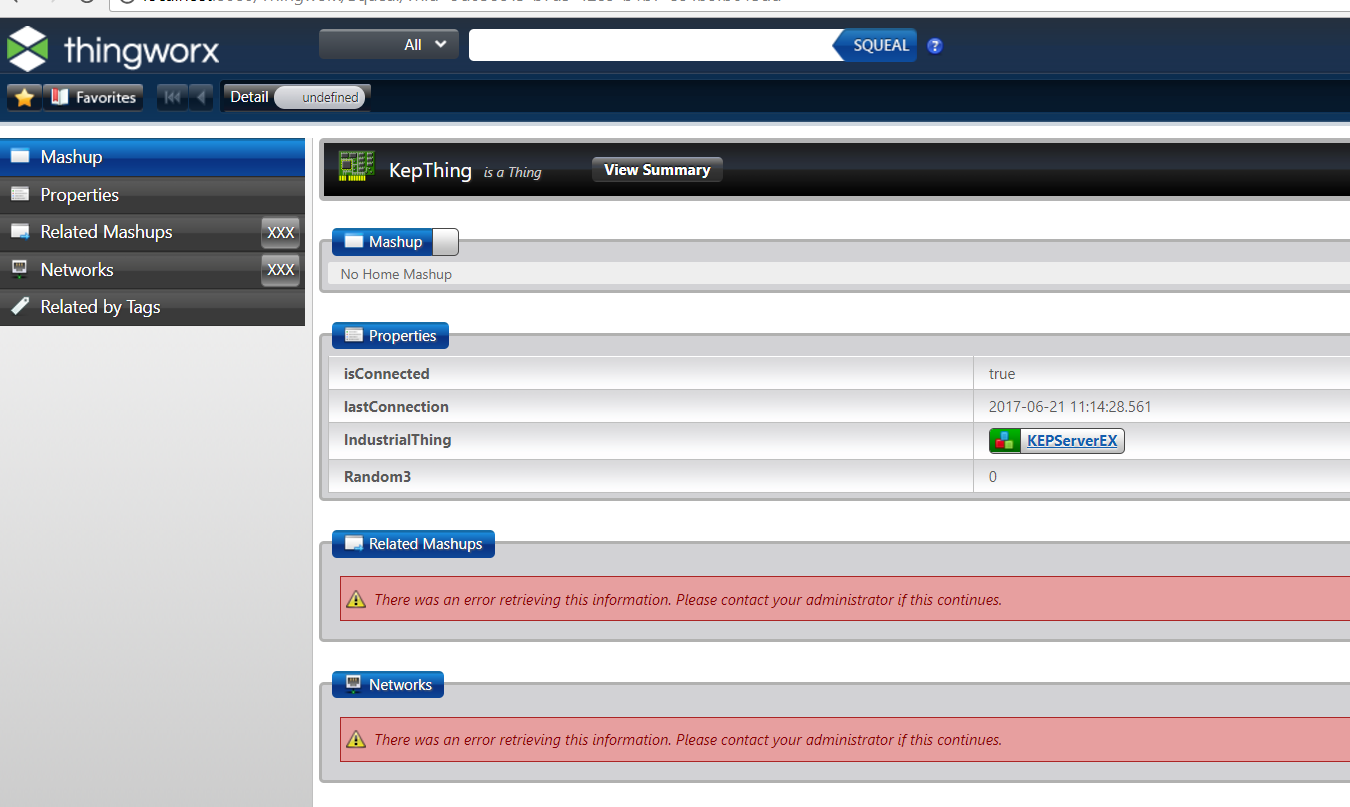

I have opened the monitor in the Composer and I can see this:
I followed the guide provided in the help center, and it doesn't mention anything about mashups and networks. Do you see something wrong? If you need more information, please don't hesitate to ask me.

That last one with the home mashup and network missing isn't important to this.
I don't see any info from the application log though?
What you can try at the KepServerEX Thing is when you are viewing the Properties, go into Manage bindings, then go to Remote
and you can redo the bindings from there and see if that will get things working.
That binding that is showing, seems not right to me, because it doesn't look like a Tag that is part of a Device in Kepware.
