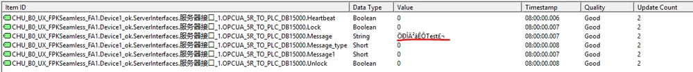

Chinese values are shown as garbled in Kepware 6.13
  • January 24, 2024
  • 4 replies
  • 1154 views
I connect Kepware 6.13 to our Siemens PLC by using OPC UA. But there is a problem that some of the messages are written in Chinese and when we try to monitor them on Kepware Quick Client, they are appeared as garbled.

Hello VladimirN,
Thank you so much for your comment. I checked the post that you shared, and found that this issue should be solved since Kepware6.8, but I am using Kepware6.13 and still found this issue. Do you know if there is any configuration that I should set in order to be able to activate this "reading Chinese" feature

@NT_10644172,
My name is Chris, and I am a Kepware Community Agent.  I recommend open a Support Ticket with the Kepware team as I believe this issue will need Kepware Developer engagement. I will be able to monitor the support ticket and potentially update this original post with possible resolution. Here is a link to the login page where a support ticket can be opened:
