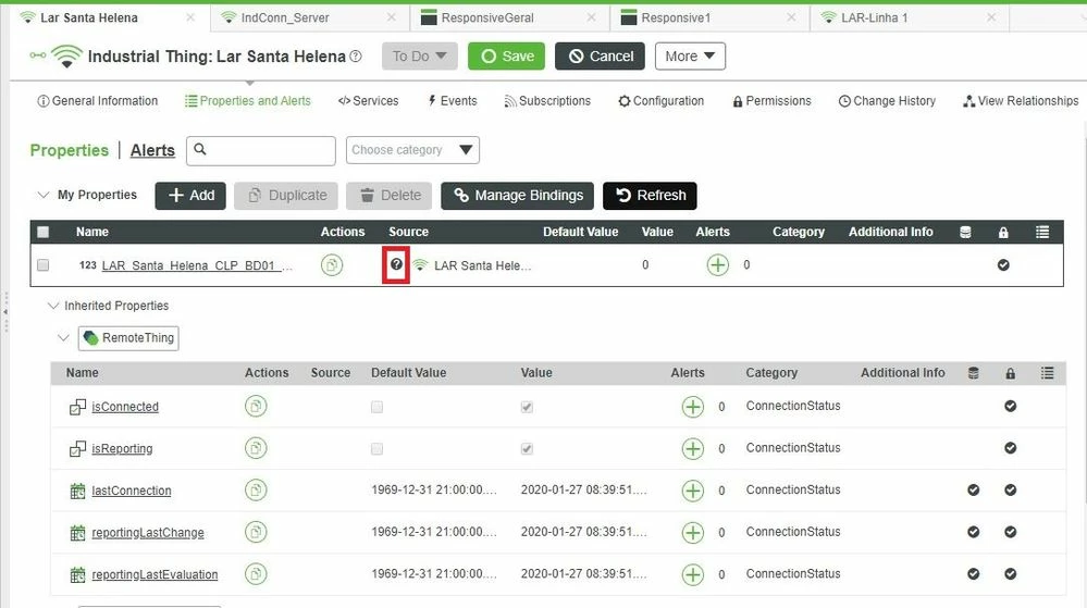

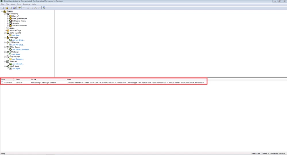

Hi everyone!
I'm having difficult to comunicate one device through from Twx Industrial Connectivity.
I have done two test:
1 -  Using one PLC local: I have one PLC at my company and I was able to communicated it, through Industrial Connectivity.
2 - Using PLC from my client: I'm trying communicate with device from my client, I have succes with the Industrial Conectivity but when I to check on the Fundation I have the signal "unknow". Images below:
Regards
Leonardo

Please take a look into Kepware logs and Thingworx logs (Application.log, Communication.log), maybe there is a hint what is happening.
You can upload logs here if you want and I will take a look.
