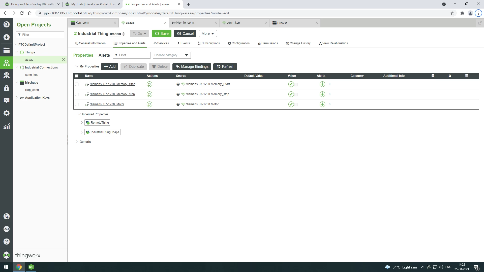

communication error between kepware and thingworx foundation to bind tags
Here i am facing problem will communicate with kepware and thingworx foundation to binding tags. I am not able to operate the plc from thingworx

Hi @RS_10015366,
There may be two scenarios:
  1. If you open KepServerEX and OPC Client, navigate to the Channel.Device1, if the Tags are bad, then there is an issue with the tags itself.
  2. If the Tags are good, but the Remote Thing in the Screenshot you have shared is bad, just save the Remote Thing. They will be good.
Note: whenever you restart the KepServerEx, you need to save the Remote Thing in Thingworx, if not in the Remote Thing Signals show bad.
