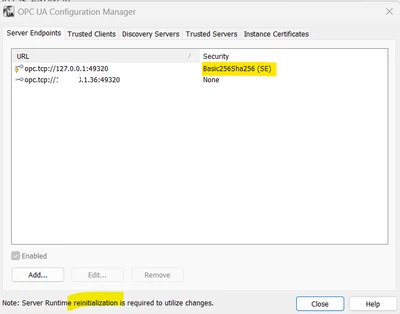

We cannot connected the Kepware sever to the DxP(OPC UA client) using  "Basic256 sing"
But We connected the Kepware sever to the DxP(OPC UA client)successful on no security.
When I turned on encryption, the following error occurred on the client side.
"Selected security is not found in server endpoints"
Please tell me what to check.

Please make sure you have configured the endpoint with security and, after configuration, performed re-initialization.
