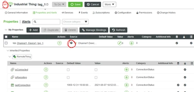

I try to create a thing linked with the Kepware Server ....it was working really well with the trial version
but with the license is not working..
i created the industrial connection with Kepware and is working well
I can read all the tags from kepware with the Discover function of the industrial connection
I created a thing with the bind function but the new thing still alway disconnected
here the log
Im sure that someone can help me ...thank you 🙂

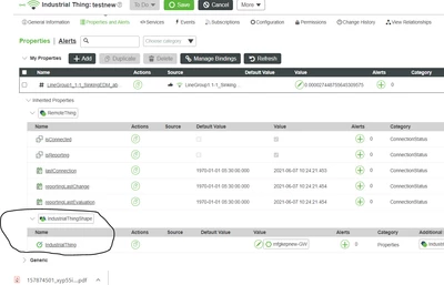

@DP_9890933 : In the thing did you checked whether the 'industrial thing' property is set to your industrial connection?

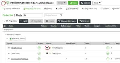

Thanks for the help ...i really appreciate 🙂
here my connection ...look like ok

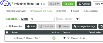

Just create again from scratch with simulate value between Kepware Server and ThingWorx fundation
and again the industrial connection is good but the thing still not connected
but why the signal is Unknown if im connected ?
