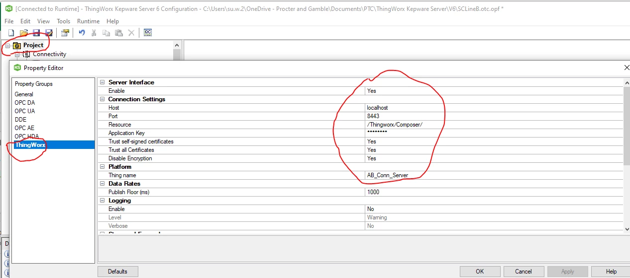

Below are couple of things I noticed,

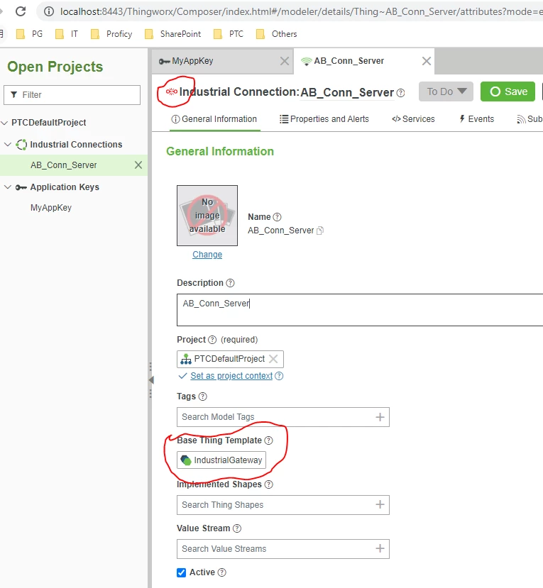

You cannot use 8443 port with http, it has to be either https://localhost:8443/Thingworx/Composer or http://localhost:8080/Thingworx/Composer
In Kepware, Project > Properties > Thingworx you cannot set Disable Encryption to Yes when using SSL so update it to No.
Update the Resource value to /Thingworx/WS

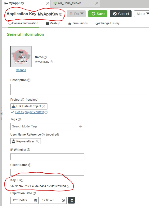

The appKey is tied to KepwareUser make sure that user has all the proper permissions.
Try to connect again after making these changes.

Sharma,
Thanks, the issue resolve while I update the Resource value to /Thingworx/WS~
