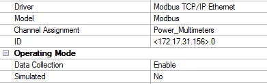

We are facing some problems trying to connect the Siemens power monitoring device "PAC3200" with KEPserverEX 6.5, using the Modbus TCP/IP protocol, the basic configuration are done using its manuals (attached) but we still have a Bad Quality in the tags.
This is basic configuration for the device:
Device ConfigurationDevice Configuration

Hello Claudio,
This device probably has a station/node/slave address assigned to it. For example the SquareD power meters have a default station address of 7 so you would use this in place of the default '0' in the Device ID, making it "<172.17.31.156>.7" .
The Siemens configuration software should indicate in some way what that station/node/slave ID is.

Hello Mr. KCorrigan,
You were totally right!!
It's working now! The ID 7 was the right ID.
