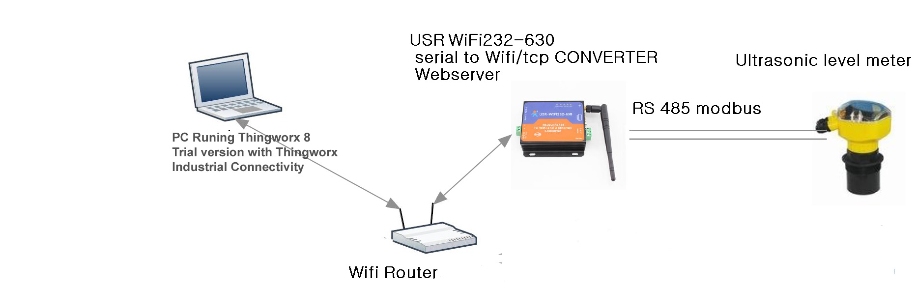

Hi there I have a MODBUS Level meter that is connected to a serial to Ethernet adaptor that I want to connect to the Thingworx Industrial connector and then obviously bring that data into thingworx. Despite reading the forum I am unable to see any clear steps as to how you would go about this for MODBUS configuration where you can set which registers to read etc.  I have seen some information with older thingworx releases with simulation but not actual real word connection. Can any one guide me through this to assist in testing? Here are the devices I have.
1) Ultrasonic Level meter with RS485 with MODBUS RTU
2) A serial to ethernet server connected to the level meter via RS485

It should be possible to use the KEPServerEX Modbus RTU Serial driver with Ethernet Encapsulation to interface with this level meter device. Ethernet encapsulation adds a TCP header to the serial-based Modbus RTU protocol. This header is removed/added as it passes to/from the Serial/Ethernet gateway. Modbus RTU is the original Modbus protocol, and even with the TCP header, it is slightly different from the Modbus TCP (Modbus Ethernet) protocol.
Follow these steps to connect with this device:
1. In KEPServerEX (Industrial Connectivity), create a new Channel, and select the Modbus RTU Serial driver.
2. Keep most of the default settings for the Channel until you see the Physical Medium. Change this from 'COM Port' to 'Ethernet Encapsulation'.
3. Create a new Device. Here you will also keep most of the default settings. Device ID will be the Modbus Slave Node ID assigned to the meter (keep this at 1 if you are unsure what this should be). The IP address/port will be the IP/port of your USR Wifi232 device.
4. Once the Device is created, create a new Tag. For the address, enter a Modbus address you know exists in the dervice (for example, holding register 40001).
5. Launch the Quick Client (the QC icon in the KEPServerEX Configuration), and locate the tag group that is named <Channel>.<Device> for the Channel and Device you created in the previous steps.
Can you see the value you expect for this tag/register?
