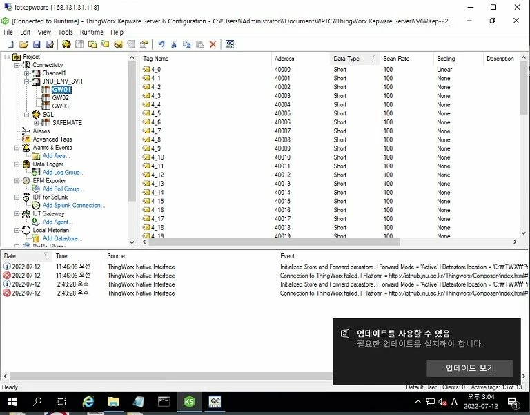

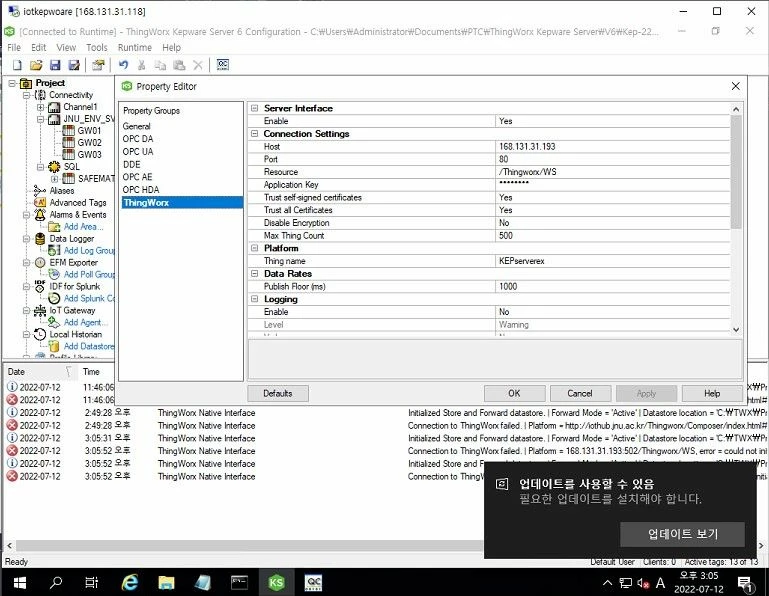

Error message is "Connection to ThingWorx failed. Platform = 168.131.31.193:80/Thingworx/WS, error = could not initialize a secure socket connection."
In thin situation, What can i do?
And, I want to know whether data is connected to kepware or not.

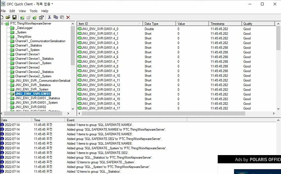

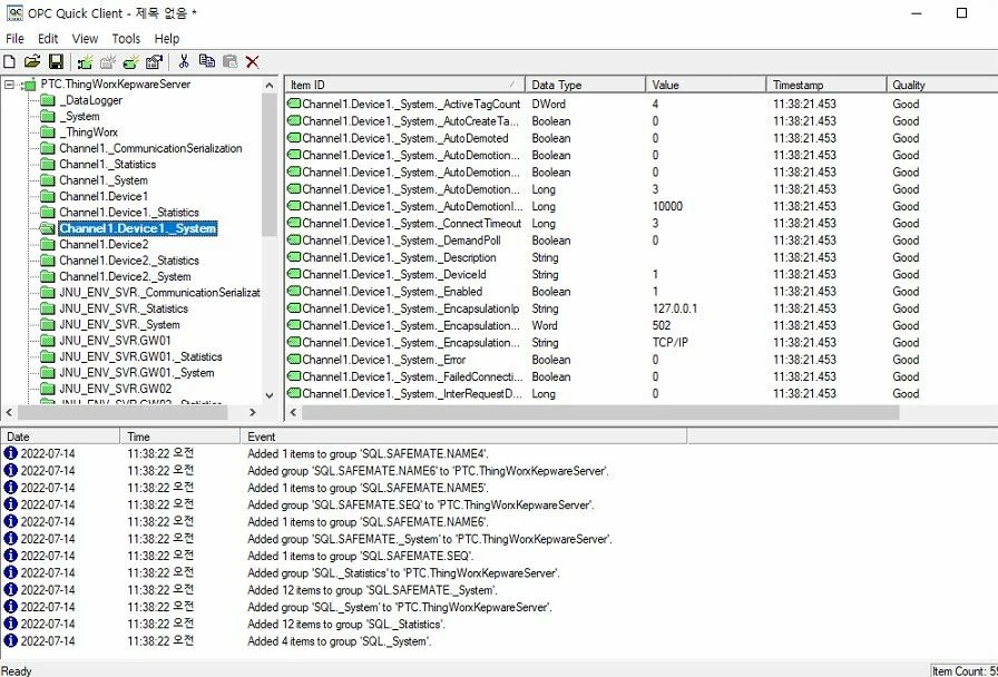

When I see Channel1.Device1._System,  I think data is incoming to kepware but value don't change.
And, when I see JNU_ENV_SVR.GW01, all value is 0.
I don't know this is connecting to kepserver well.

1. Articles:
  • "ThingWorx connection to Kepware installed on a different machine is failing with error "Connection to ThingWorx failed.| Platform = <domain:port>/Thingworx/WS, error = could not initialize a secure socket connection"": https://www.ptc.com/ru/support/article/CS331613
  • "Connectivity between KEPServerEX and PTC hosted ThingWorx instance failing with error "Connection to ThingWorx failed.| Platform = <domain:port>/Thingworx/WS, error = could not initialize a secure socket connection"": https://www.ptc.com/en/support/article/CS297659
