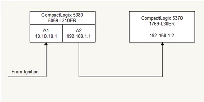

Trying to connect to an L30ER through an L310ER in Dual IP Mode. KEPServerEX Version is 6.10
As close as I can tell, the ID should be:
<10.10.10.1>,1,[4,192.168.1.2,1],0
However, I get an Invalid Device ID
I can connect through Ignition's OPC server with a connection path of. 4,192.168.1.2,1,0, but I'm not sure how that translates to KEPServer's ID.

This is not possible within the driver at this time. Please refer to this article where that functionality is mentioned under the "Limitations" section.
https://www.ptc.com/en/support/article/cs299190

Thanks, Andy. Do you happen to know if there's anything on the roadmap for this?
March 14, 2023
I have not heard of it being added to the product roadmap yet.
