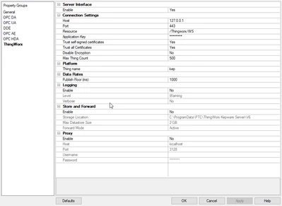

Connection to ThingWorx failed. could not initialize a secure socket connection
I tried to connect with ThingWorx Kepware Server.
However, it does not work. I connect to the composer locally by doing: http://127.0.0.1:8080/Thingworx
Here is my configuration:
Does anyone have an idea of how to solve this issue?

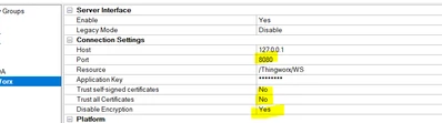

@AF_9440574 Is your thingworx SSL enabled? If not, then please change the configuration as per below screenshot.

Jun 10, 2022 7:11 AM UTC
I forgot to enable SSL, thank you!
