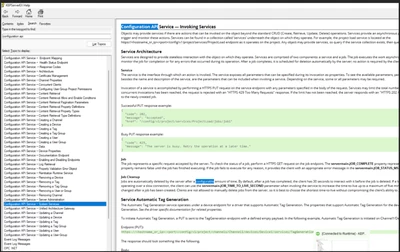

May 2, 2024 3:18 AM UTC
Hello @cmorehead
Thank you for the update. I have opened case to PTC team case ID: C17323207.
But, I'm having question for this below green highlighted line. Because we have made the Batch script to copy the file from one place to other place.
Workaround: use a batch script to copy the .opf from one system to another, and then through the Config API call the endpoint to replace the project.
How to Call config API from endpoint because I have checked below snapshot but I'm blank how to configure it, if you could help me here to solve this issue. You can create test environment from your end if you demonstrate me then I'll do it myself and learn new thing.
Best Regards,
Bhadresh Rangi
cmorehead13-AquamarineAnswer
May 2, 2024 3:26 PM UTC
@BRangi
You would need a third-party API Platform application like Postman. Here is a link to Kepware training video that covers the use of Postman with the Configuration API:
Configuration API (youtube.com)
Here is also a link to some example scripts:
Kepware-Example-Scripts/Config API at master · PTCInc/Kepware-Example-Scripts · GitHub
*Chris
