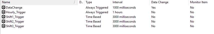

Created one more trigger in Data Logger but data is not being logged
Hello Community,
I have created a trigger for already created Log group in Thingworx Kepware Server v6.16 Data Logger.
Other triggers are working but created trigger is not working.
Created Trigger:
1. Always Trigger
2. Trigger on Data Change
Any solution?

Greetings,
Please ensure the static interval of the logging condition and the update rate time are aligned.
If the issue persists, please submit a support ticket along with the relevant application report and provide us with the corresponding case ID.
