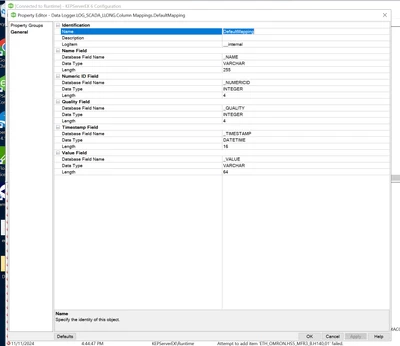

I am reading via OPCUA a variable LLONG. on the OPC Client simulation the variable is visible.
when I try to add this variable to the DATA LOGGER , and create a dedicate table for this type of data, there is no way to be able to write on SQL table and start the LOG.
the alarm is
Date Time Level Source Event
11/11/2024 4:59:19 PM Warning Data Logger Plug-in Failed to register log item 'LogItem1' for log group 'LOG_SCADA_LLONG'.
apparently there is no other messages. I setup a LONG value, from a similar or identical OPC device and there was clear indication of the issue.

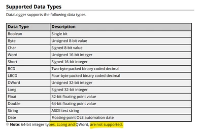

I checked the data logger manual (page 8), and it states that LLong is not a supported datatype.
It requires an enhancement request to add this feature. Please take a look at this article with instructions on how to submit that request to our Product Management team.
