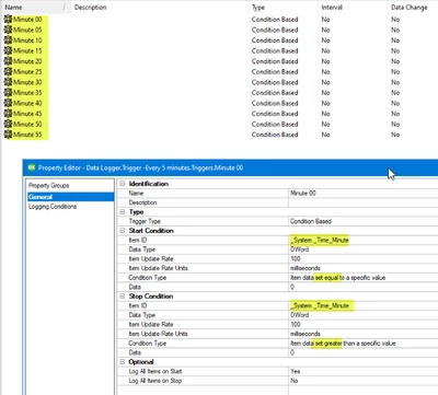

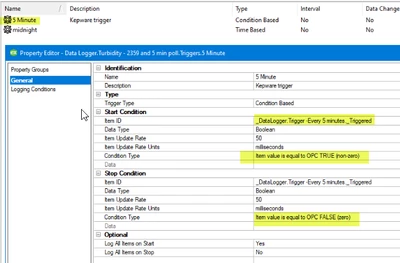

This might be easier. First one sets up the triggers and the second one uses them. Only logs one time per rising transition
10 replies
