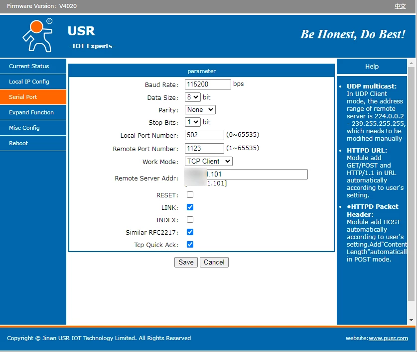

I'm having trouble setting up Kepware OPC Server to read data from my PLCs.
My Setup:
- PLCs: Use Modbus RTU communication protocol as masters (initiate communication).
- Kepware OPC Server: Used to acquire data from PLCs.
- USR-TCP232-304 Module: Converts RS-485 communication from PLCs to Ethernet for Kepware to access. (Link to user manual: https://www.pusr.com/download/M0/USR-TCP232-304-User-Manual_V1.0.3.01.pdf)
The Problem:

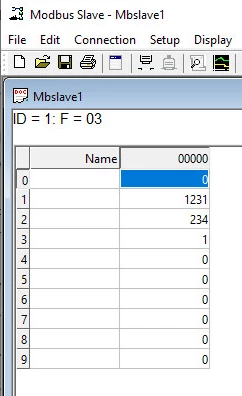

I can successfully receive data using a "Modbus slave" emulator software.
However, Kepware OPC Server fails to receive data from the PLCs.

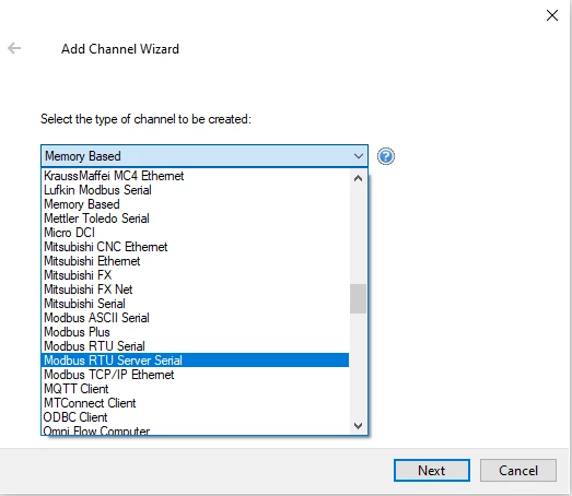

My Kepware Configuration:
Driver: Modbus RTU Server Serial

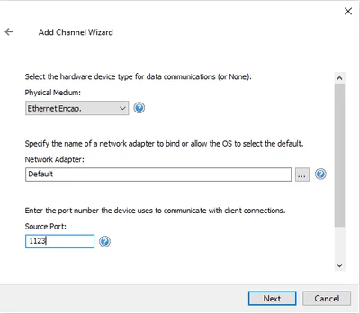

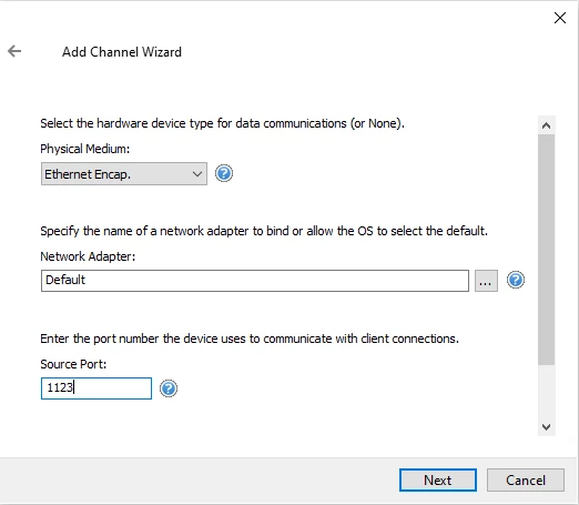

Physical Medium: Ethernet Encap.
Port: 1123

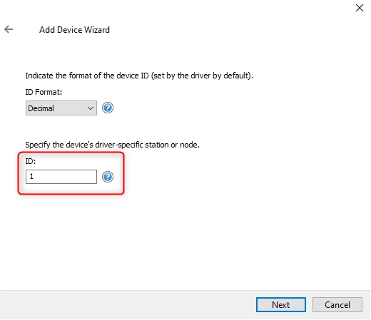

Device 1: ID 1 (matching PLC master write address)

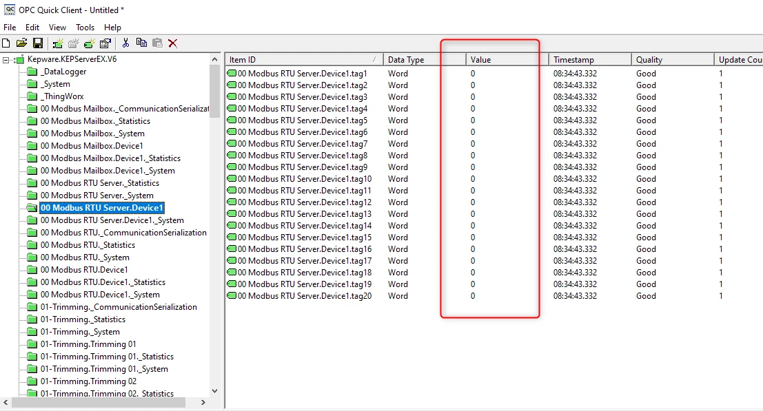

What I Need Help With:
Can someone advise on the correct Kepware driver for my setup?
Are there any additional configuration steps required for Kepware or the USR module to establish communication?
Any troubleshooting tips for Kepware's diagnostic tools to identify specific issues?
Additional Information:
(The PLC are using is Mitsubishi FX3G)

I am confused by the last line your post, where you say the (The PLC are using is Mitsubishi FX3G). If this true, then the Kepware Mitsubishi FX Driver should be used. I recommend opening a support ticket with the Kepware team to take a closer look at your specific architecture. The Kepware support team can utilize both the built-in communication diagnostics and third-party tools like Wireshark to analyze the connection.

Our system uses many different types of PLCs (Mitsubishi, LS, Siemens), and also includes devices that use Modbus. Besides, our kepware software only uses Modbus suit
