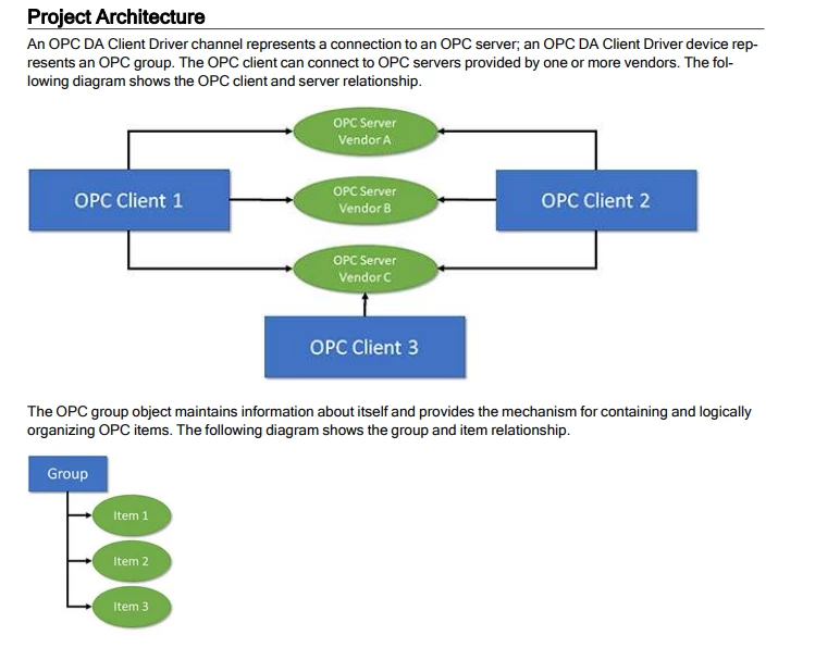

Does kepware works as OPC DA server?
I working on one of my projects. As per my application, I want to take data from DCS over TCP/IP into kepware. From kepware i want to publish those data over opc da for other SCADA/DCS that works as opc da client. My quetion is does kepware works as OPC DA server for this application?

Yes, Kepware can Work as  DA server
The OPC DA Client Driver in Kepware provides a reliable way to connect OPC DA Client devices to OPC Client applications, including HMI, SCADA, Historian, MES, ERP and countless custom applications.
It can be used to consolidate data from a number of OPC servers and is made available to server clients through all supported interfaces (such as OPC DA, OPC DX and so forth)
The OPC DA client driver supports OPC DA 1.0, 2.0, and 3.0 connections with underlying servers. It uses 2.0 calls if supported, and automatically falls back to 1.0
