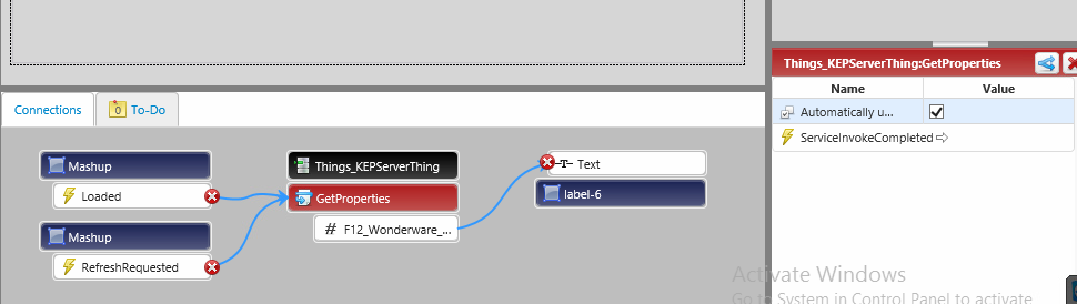

I had linked ThingWorx to KepServerEx and would like to display the value on screen.
I am using the GetProperties service and check "Automatically update value when able" checkbox
but I got error
if I uncheck the ""Automatically update value when able" checkbox, I got value showing on screen but not changing.
any reason why?
thank you

Can you check the application log to see if there are any more detailed errors?
7-Bedrock
December 29, 2016
Greetings!
I have never used the “Automatically update..." checkbox, but it is possible to add an Auto Refresh widget to the Mashup and use it as an Event Trigger for GetProperties. Auto Refresh has an adjustable refresh interval and a property that allows controls to be hidden.
Another way would be to use the ServiceInvokeCompleted event on GetProperties, but I suspect doing so would introduce unnecessary load since the service will then run continuously.
I hope this helps.
December 29, 2016
Eric, was this on IE 11 by any chance? In any case, this has been fixed in the 7.2.6 and 7.3.0 versions of ThingWorx.
echo1-VisitorAuthor
December 30, 2016
Thanks guy, finally i got it solved, which caused by the ThingWorx permission checking.
With this new function, the Auto Refresh function and extra event is not required anymore, very handy (to me).
For your all info, I am using ThingWorx 7.2 on Windows server 2012 and am using IE 11 to do the composing and viewing.
