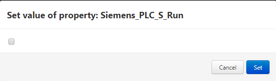

I connected some tags in kepware and I want to read/writing them using an experience in Thingworx  Studio.
When reading, it works just fine, the problem is when I try to write a property.
If I set the property manually from Thingworx it works correctly and I can see the change in Kepware
To be clear, when I click the button 'set' I can see that the value in OPC (and in PLC) is changing
To write from Thingworx Studio I made an experience with a button that takes the text input from a text box and take the output as a parameter, then I bind it to a custom service

Note that the input (that I conveniently named 'Input') is bond to the text. You can see that i'm using UpdatePropertyValues
Well, the problem is: When I write a value in thingworx studio using this service (I configured it to Invoke on start-up, take the first row and auto-refresh 0.2) it show in ThingWorx that the value in the property changed (If use GetPropertyValues I can see that it really changed) but in OPC Client it simply does not change and Thingworx stop reading from OPC too (The property just take the value in the text box from the studio experience).
How can I solve this? Or, there is any better solution to write a property from Studio?

Interesting!! Did you try directly executing the service in ThingWorx Platform and see if that updates the values in kepware/OPC? ? Technically, if Studio pushes the values to ThingWorx Platform, then it is all with ThingWorx Platform to carry the task. Not sure why this isn't working in your case. Also did you notice errors in logs (thingworx Platform)?

I executed the service directly in ThingWorx Platform and I've got the same error:
ThingWorx set the property to one
But OPC does not set the tag
Crazy, right?
No errors in logs too.
I wonder if it is a problem in the Service or in UpdatePropertyValues...

It seems like when I execute the service I still have to click on the "set" button to ThingWorx actually work
