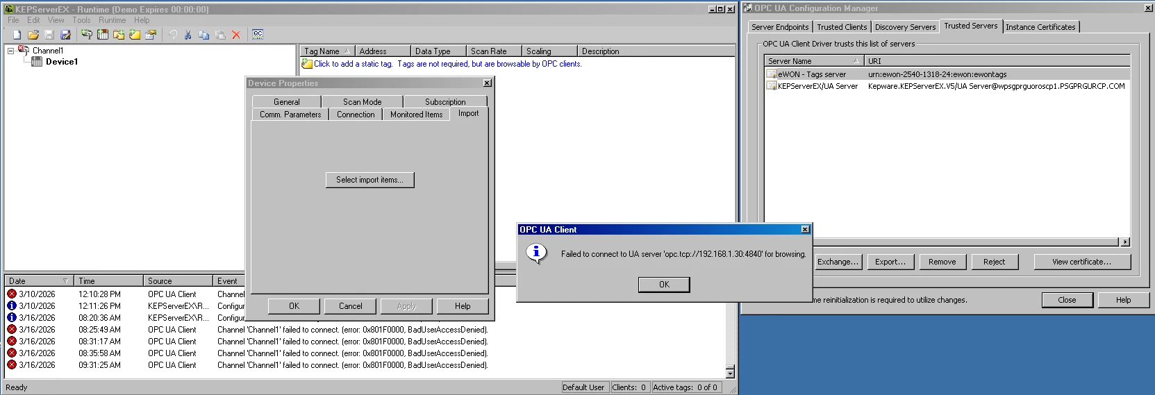

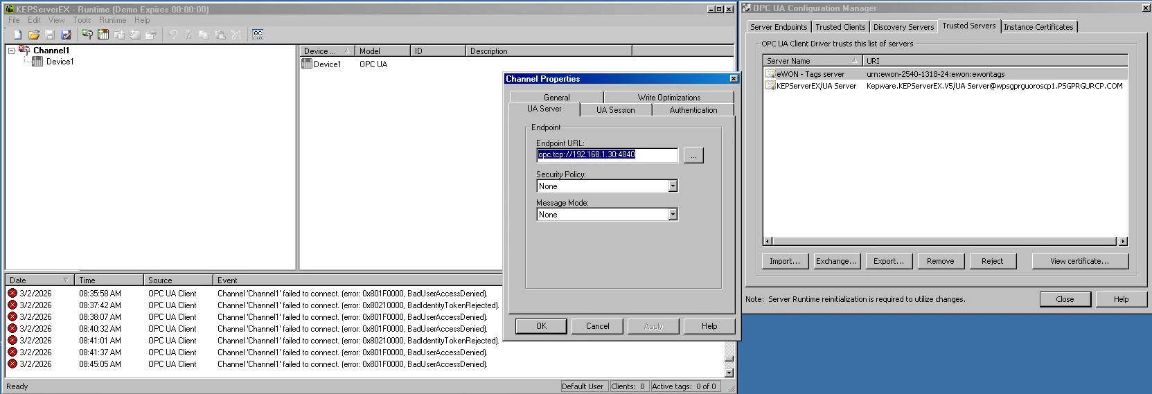

When configurating KepserverEX 5.8 channel i use OPC UA and configure UA server in the channel (see attachment 1) and when i try to import items on  the device to import the tags of the Ewons an error appear (see attachement 2).

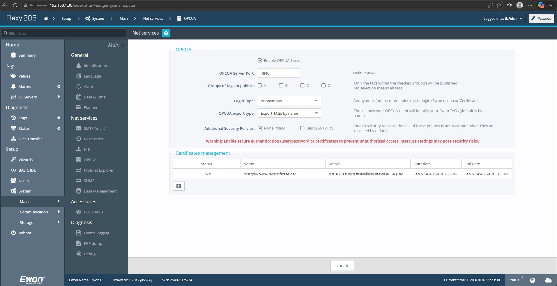

See attachement 3 for ewon configuration.

In the screenshot you shared, I noticed the error: “Bad_UserAccessDenied, 0x801F0000.”
This error is not recoverable under the OPC UA standard, which means the OPC UA Client is justified in stopping any further reconnection attempts.
This indicates that the issue may be related to the specific environment or security configuration. I would recommend testing the same setup in another environment to determine whether the problem is isolated to the current system.
