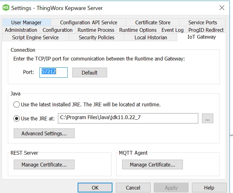

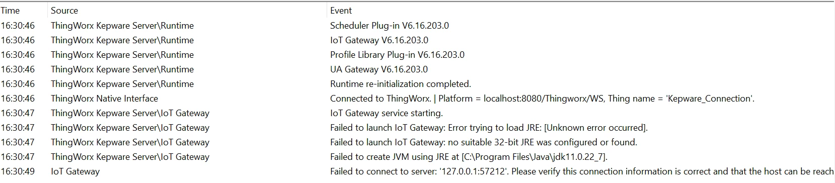

While Configuration I gateway for MQTT Client showing error  Failed to create JVM using JRE .
Check error image also IOT Gateway configuration.

Ok. I have checked  this one. In solution it was saying reinstall lasted  java version. but I have java 11.0.22 installed. I cannot upgrade it. Is any other possibility with existing java.

@KG_96 , I understand that you are using the version of Java which you feel is approate. When I read the steps in the online documentation.  Failed to create JVM using JRE at <path to JRE>, It is possible that some process has changed the JVM. To start from a known point repeat the install. The other item is to verify that the Gateway is using the version of JRE which you expect. If there was any upgrade it is possible the configuration points to an old location/value
