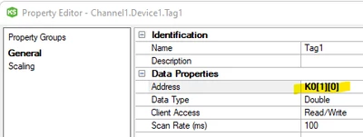

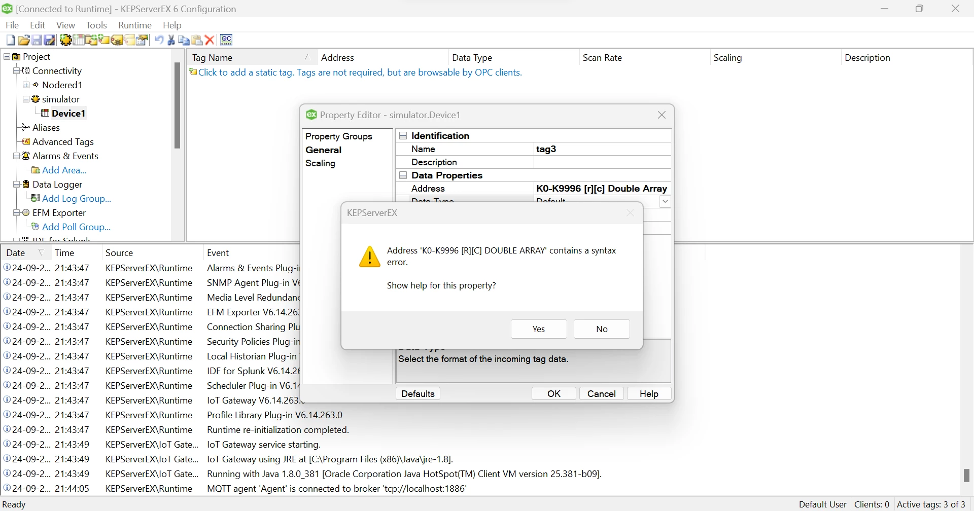

Getting Syntax Error while configuring Tags in Simulator
Team,
Need your help, i am getting a syntax error while configuring the Tags for the Simulator enabled Channel-Device.
Please find the attached file for your reference.
Regards
rajskumarAnswer
September 25, 2023
The array's address is defined as Register[row][col]
Please try for example K0[1][1] means element of 1st row and 1st column of an array of K register
Also specify correct data type.
rajskumar16-PearlAnswer
September 25, 2023
