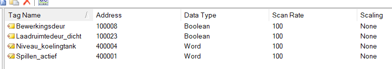

Hello, I am using kepware for reading out the signal of my PLC.
The following image shows 2 random digital inputs and 2 random analog inputs.

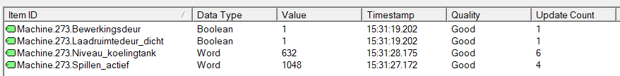

As shown in the next image, they work fine:

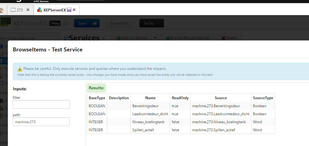

In Thingworx at the service tab i can find all the 4 inputs.

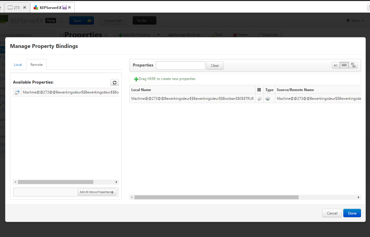

But when i try to manage remote bindings the program only find the first input. (this input works fine, i have used it in a mashup)
Can someone help me with this problem?! In the future i have to read out 64 digital inputs and 5 analog inputs!!

If you are using Thingworx 7.4, binding multiple tags is much easier using the Next Gen Composer. A step by step example can be found in the help center here PTC.
Otherwise, using classic composer will require a more manual process. There is a great example service posted in this community thread.
Get Tags From Kepware

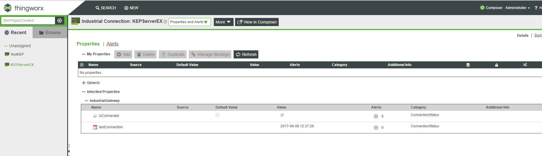

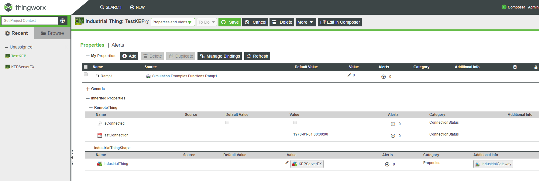

Hi Saeed,
I have a similar problem. I successfully connected Kepware to Thingworx and I added a tag by using the new composer as described in the guide you mentioned. I get the tags but I cannot get any value... seems like the industrial thing is not connected... Can you help me on that?
Many thanks
KEPServerEx is the industrial connection and TestKEP is the industrial thing.
