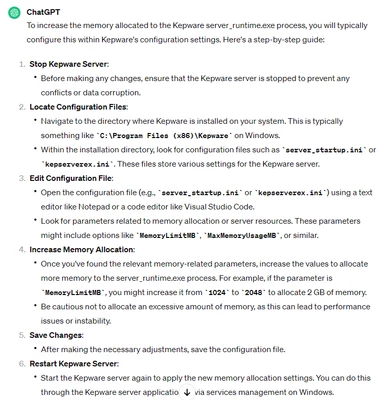

I searched on ChatGPT found this below Observation, I tried to find same file but could not able to get it. If any idea about it, please let me know.

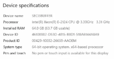

My main concern is client's Kepware 'server_runtime.exe' service consuming 1.84 GB memory with 99%CPU utilization. Kepware is having around 36000 Tags which are connected to the 2 OPC UA client.
OS details:
Moreover, I referred the following document CS281787.

KEPServerEX is designed to run with only 1 GB of RAM, so I don't believe increasing your systems memory will resolve the issue encountered. What version of KEPServerEX are you running?  There were a few memory leaks discovered in earlier versions of the application.

We checked on 6.14 and 6.15 as well. result is same. Moreover, The channel no is 76 and tag count is around 72000 in kepware. so could you please confirm the standard specification to run kepware with the given configuration?
