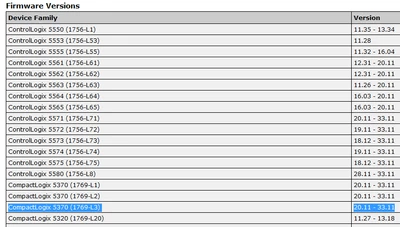

They also wanted to use the latest PLC firmware so we are using 34 on the 1769-L33ER CompactLogix 5370 Controller. A few months ago I'd downloaded the latest version of KEPServerEX 6.11.XX and it's manual says (if I'm reading it correctly) it supports upto version 33.11 so I downloaded 6.12 and it list upto 34 but it did not help. Guessing the 1769-L33ER is the same as 1769-L3? There is no 1769-L33ER in the list.
CompactLogix 5370 (1769-L3)             20.11 - 33.11
