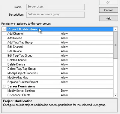

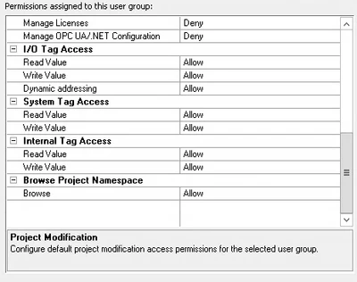

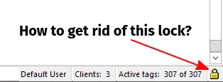

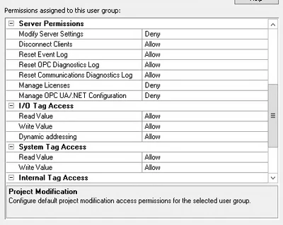

My runtime configuration is locked.  I cannot find information in the manual about this condition or how to remove it.  Does anyone know how to remove this lock?
VladimirNAnswer
March 3, 2024
Take a look - "Configuration not launching in v6.12 of PTC Kepware Products": https://www.ptc.com/en/support/article/CS373678
VladimirN24-Ruby IVAnswer
March 3, 2024
