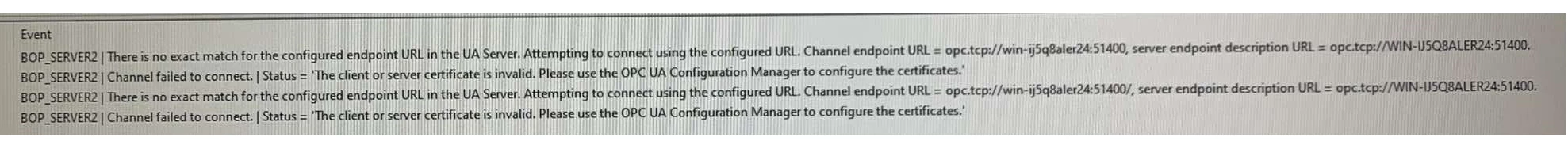

IFIX 5.9 OPC UA SERVER TO KEPWARE OPC CLIENT
hello im have some trouble on connecting Kepware opc client to IFIX 5.9 opc ua server
event log
(the client or server certification is invalid please use the OPC UA configuration manager to configure the certificate)
cant browse the tag on ifix opc server
note  ( kepware is no license yet)
but when i use the OPCUAEXPERT soft same config on the endpoint and i can browse the tag from the IFIX database
Nov 25, 2024 1:50 PM UTC
Please take a look at the following article as it may help resolve your issue:
https://www.ptc.com/en/support/article/CS324697
If you are prompted to log in to view the complete article, you can use your MyKepware login credentials.
