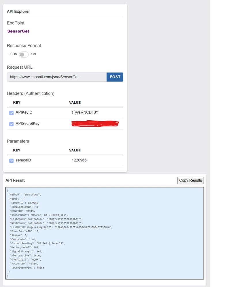

First I want to say that I am rather new to this, just learning my way through an existing system. I don't know a ton about APIs or KEPServer. I've been tasked with taking wireless sensors and retrieving their data through Rest API. The sensors are known as Alta Monnit Sensors. Their web portal showcases a way to retrieve data this way.

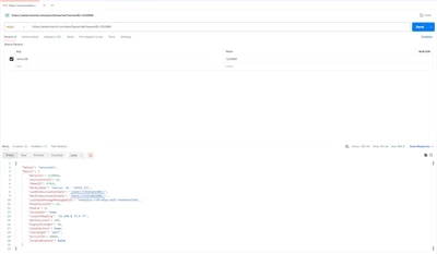

They also have a guide on how to receive the data utilizing Postman
Now I believe what I want to do is create on IOT Gateway Agent, use "https://www.imonnit.com/json/SensorGet?sensorID=1220966 " as my URL, POST as my method. However from here, if I'm on the right track, I'm not sure how to get the data into tags.
Any advice?

Yes, you are on the right track. Here are a few links which might help you started:

As a form of solving my issue, I made a Python Script that sends a POST Request to Monnit, stores that needed data from the reply, then sends a POST message to a REST Server Agent telling it to update simulation device tags.
I would personally like to remove the middle man, the python script, from this process, but it works.
