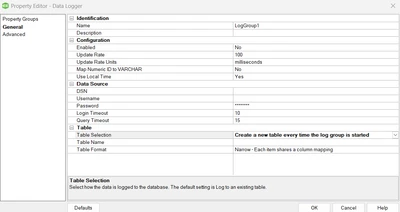

Is there a way to enable and disable the log group with a trigger from a PLC? I need to have the data logger create a new table each time the log group is triggered.

Creating an new table name each time is an unusual appr
oach. Appending is all I have ever seen done. Queries using an ever expanding list of table names , which would be required to use the stored data, is something I personally have never seen done.

Yes, we can configure Datalogger to create a new table every time new log is started.
Please check the image attached and Manual.
If you still have doubt please open a support ticket with us, Login to mykepware.com.

Thank you for your reply.
We need the data logger to create a table each time the log group is triggered not enabled? The log group does create the the new table each time it is manually enabled but not each time the logging is triggered from the PLC to start. The log group has to be enabled before we can trigger the logging on and off via a PLC tag. When we enable the the log group, that is when it creates the new table, but it appends the log data to the same table each time we trigger the logging to start. We need separate tables for each triggered data log event from the PLC.

Greetings @JH_3782320
It sounds like you want the data logger to create a new table each time the log group is triggered by the PLC, rather than relying on manual enabling.
To achieve this, you’ll need to configure your data logger to dynamically create a new table whenever the logging process starts.  Unfortunately, not all data loggers have this feature built-in, so you might need to explore specific settings or custom solutions.

Greetings,
